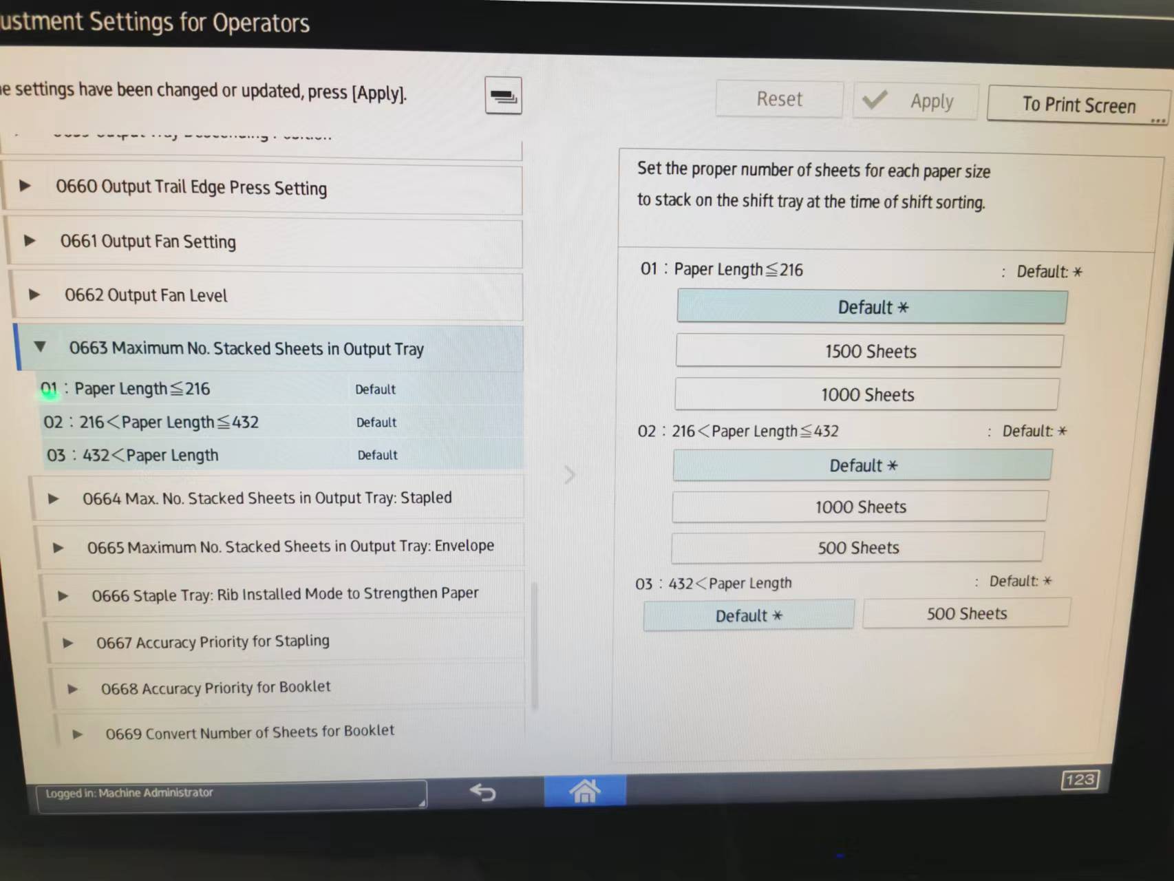

you can increase the capacity in 0663 adjustment settings for operators. the default setting is based on the paper weight and size, 200 sheets of the 13x19 cover are about what I am getting too.
for the jam issue, since you have the plockmatic finisher, so the finisher output tray is removable, make sure you put it in the right spot, it will cause overload if it is off center.

We have that tray, as well as a stacker, on our machines. Ours will stack about 12" of gloss paper, but if you run more it says there is a mechanical fault. Our tech says the solution is to change a setting to allow less volume. It just seems to be a limitation of that component. The stacker is great, but I miss being able to see what's coming out.

I have the same issue on my booklet finisher, the 7110 holds so much more, guessing they limited it on the 7200 due to having issues with weight. I don't have that 0663 option on my 7200 with the booklet finisher.
