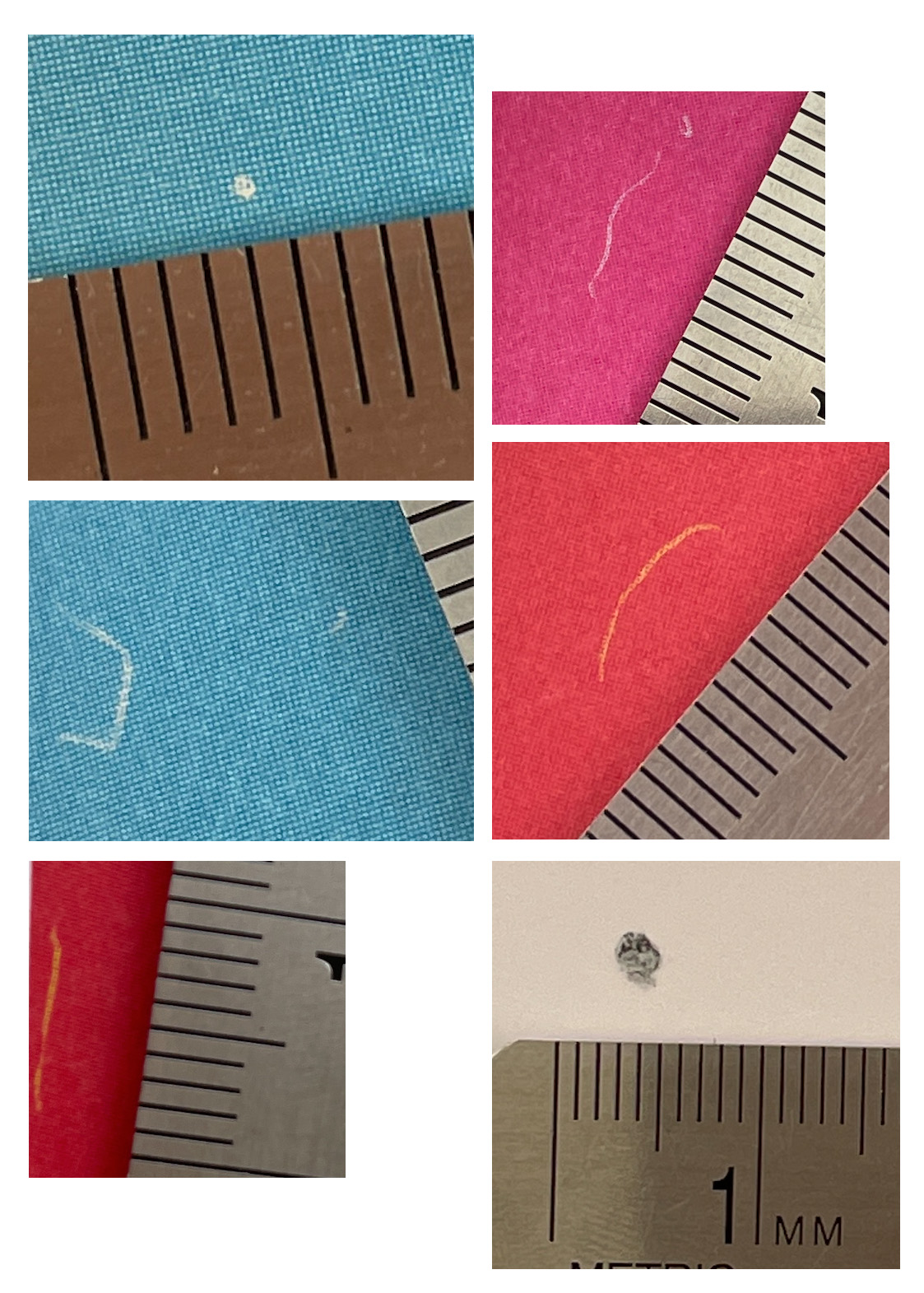

Here are samples of the defects on uncoated stock. The scale is in millimetres. What are the causes? Is this acceptable? Would dusting the sheets have helped? Remember the run is only 650 copies. Would running the press slower have helped?
Magnus59
I would say this is the result of poor press hygiene and maintenance.
Contamination in the ink train and on blankets, probably not from the stock used for the job, but from jobs printed prior without attention to cleanliness.
turbotom1052
The defects, as mentioned, could come from many possible places. The most likely would be from the stock. Did you spec a particular stock, and if so was it a premium branded sheet? Did your printer say or imply that they would provide the paper, and that it would be of a known quality? Was the paper cut to press size from a larger sheet?
One thing thats important to understand is that a run of 650 sheets happens in the blink of an eye on a modern sheet fed press. You can only run a press so slow, before the slow press speed contributes to certain problems. On a run of 650 sheets, the very act of starting and stopping the press a couple of times, creates quality problems that may be even more visible than the defects you mention. Every time you stop and start a press up it has to re establish its running ink tack, and ink water balance.
The only ways to minimize defect free printing is to insure that all of the materials being used are of the highest quality. A suitable amount of paper needs to be provided to get up to color, and to have enough overs to cover frequent press stops when cleaning up these defects. It would be best if the paper did NOT have to be cut from a larger size, and instead run right out of the carton. If the paper must be cut to size it is imperative that the stock is "back trimmed" with a sharp knife, and that the edges are wiped down with a tack rag.
You as a customer should be willing to incur the additional costs that come with all of the measures I mention above. If you shop printing on price alone, disappointments like you mention are going to be par for the course.
turbotom1052
As far as dusting the sheet either before or during printing, i will say this.... Ive seen it greatly improve paper debris problems, and Ive also seen it do more harm, as a result of loosening up particles. Sizing of the paper can have the same effect. If you must size the sheet it is my recommendation that it be done as a separate pass, and allowed to dry, to give the inks the best chance of properly trapping!!! All of these additional steps can quickly ad lots of cost to a 650 sheet run.
