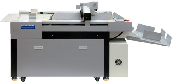

Inkscape Print
We us the Duplo Digital Die Cutter. We have a Scott tab cutter but since we got the die cutter that seems to be the way to go.
  • Like
Reactions: bcr
Ynot_UK
On the downside that would be much slower than the Onglematic 5 hand cutter the OP linked to in the first post, however on the upside, it is automated so you can walk away and let it run and you can design whatever style of tab you want on the fly, whereas on all the Onglematics you generally commit to one style and buy the corner die for that pattern.
The Scott tab cutters seem to be the way if you're doing thousands of tabs on a regular basis. Before getting the Onglematic 6P+GP, the finishing house that did our tab cutting used a Scott. Being able to make small quantities and samples for trial/client approval are a big advantage of both your Duplo - we have the same machine (Veloblade) from Vivid - or indeed the Onglematics.
