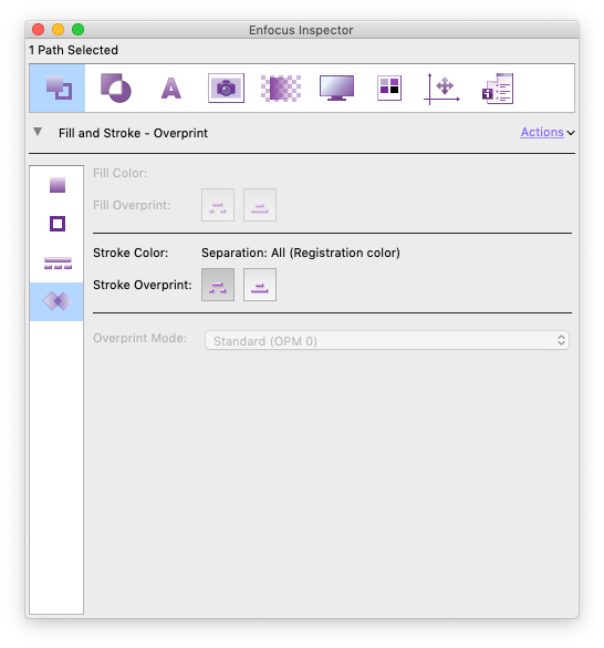

Select the object(s) and adjust fill or stroke overprint here.
