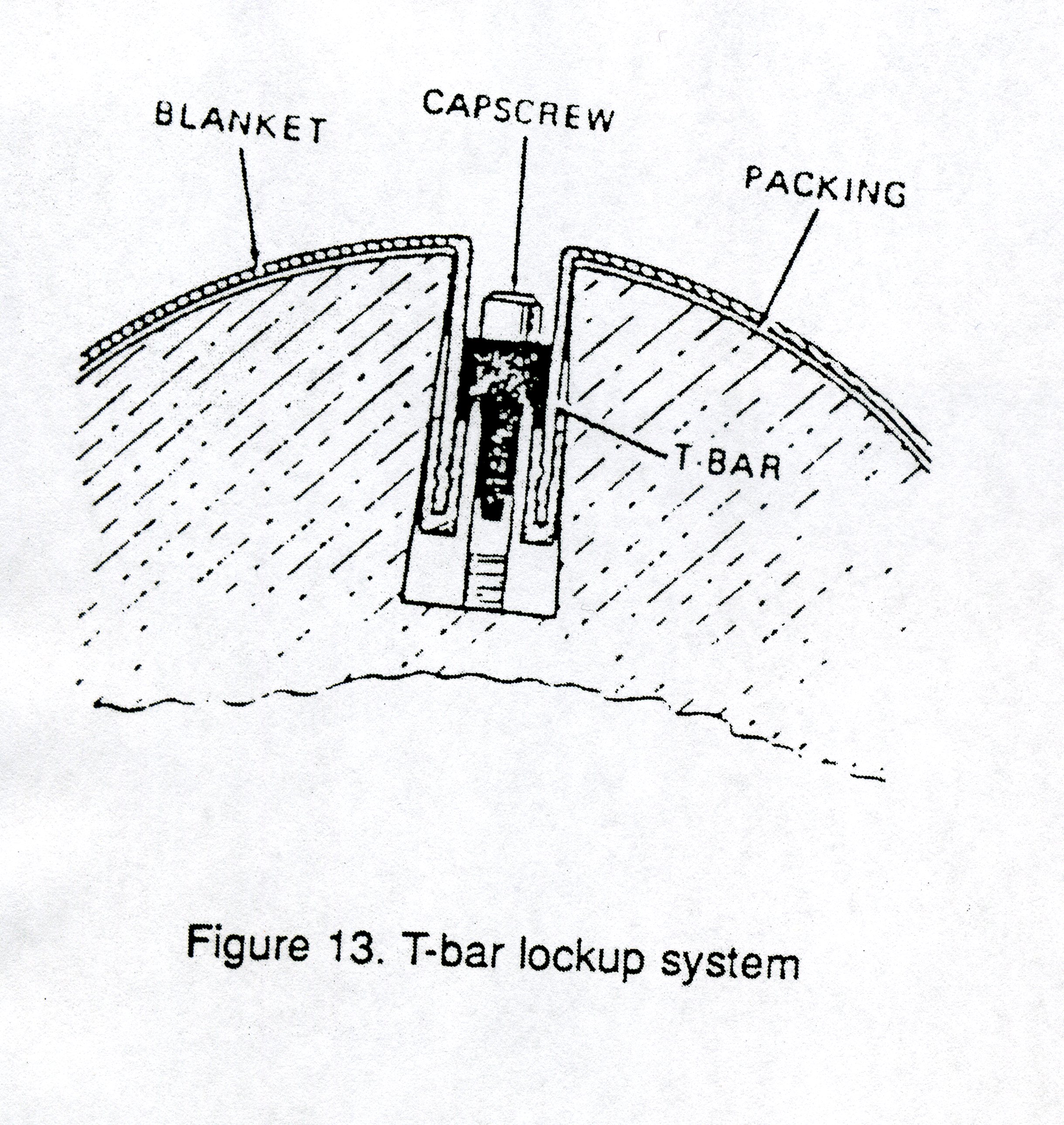

Blanket dimensions we use are 24.69 X 35.
We run Day 9500 3Ply Compressible.
We are having problems with blankets torqing down tight to cylinder. We torque them to 35lbs but you can still feel a bubble underneath blanket unless you take it down a few more turns with a T Handle which you shouldn't have to. Paper packing gets wet pre-maturely because of this I believe.
Anyone else experience this?
