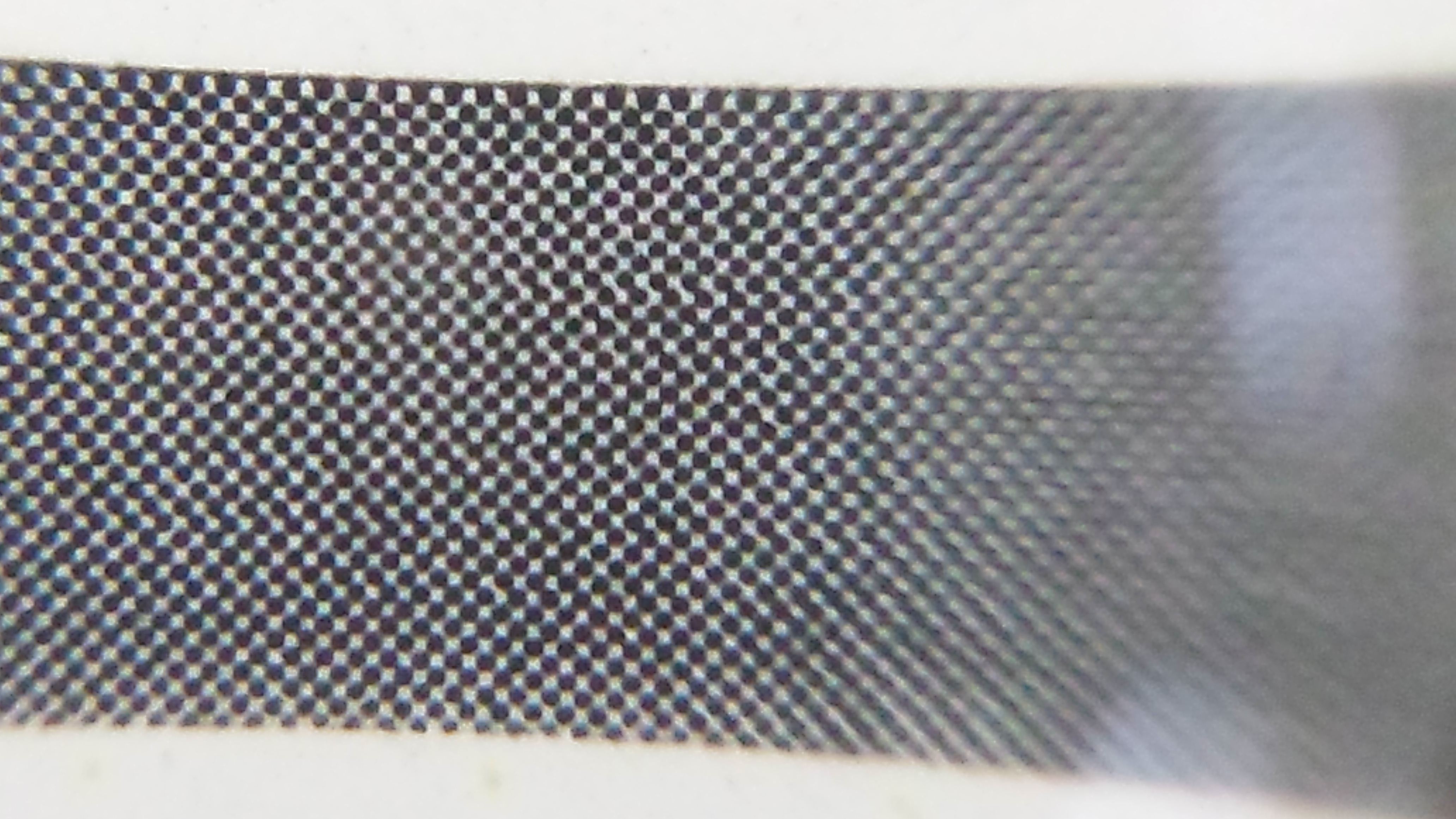

See if this works. It doesn't help when I shake the camera either!! 20150617_105401.jpg
Hey Josh - For shits and giggles, what line screen are you using and did you calibrate to that screen? Also in the RIP under image tab have you have played with text/graphics enhancement or text/graphics quality settings?
See if this works. It doesn't help when I shake the camera either!! View attachment 4911
It's tricky to see on that. Is the bottom of the image the trail edge?
