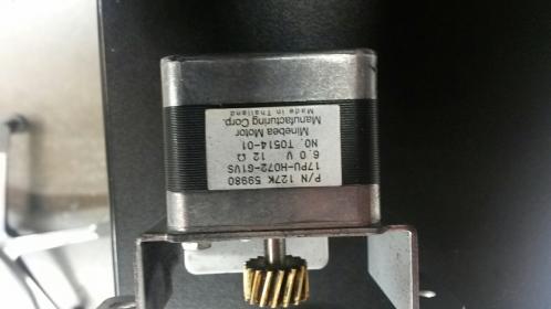

It is definitely backing up in the IBT Cleaner. The motor appears to be spinning but if you take the cleaner out and auger it by hand, it ejects a big pile of toner. So my conclusion at this point is the drive motor for the ibt cleaner might be spinning intermittently. It has the manufacturer's information on it but I called them and they said I'd have to call Xerox.
Does anybody happen to know the XEROX part number for this?
P/N: 127K59650 Motor Assy-IBT,CLN
Received this motor and installed it and it has been running streak free now for a couple of days. I am hoping this one is solved. Thanks for all the good advice!
