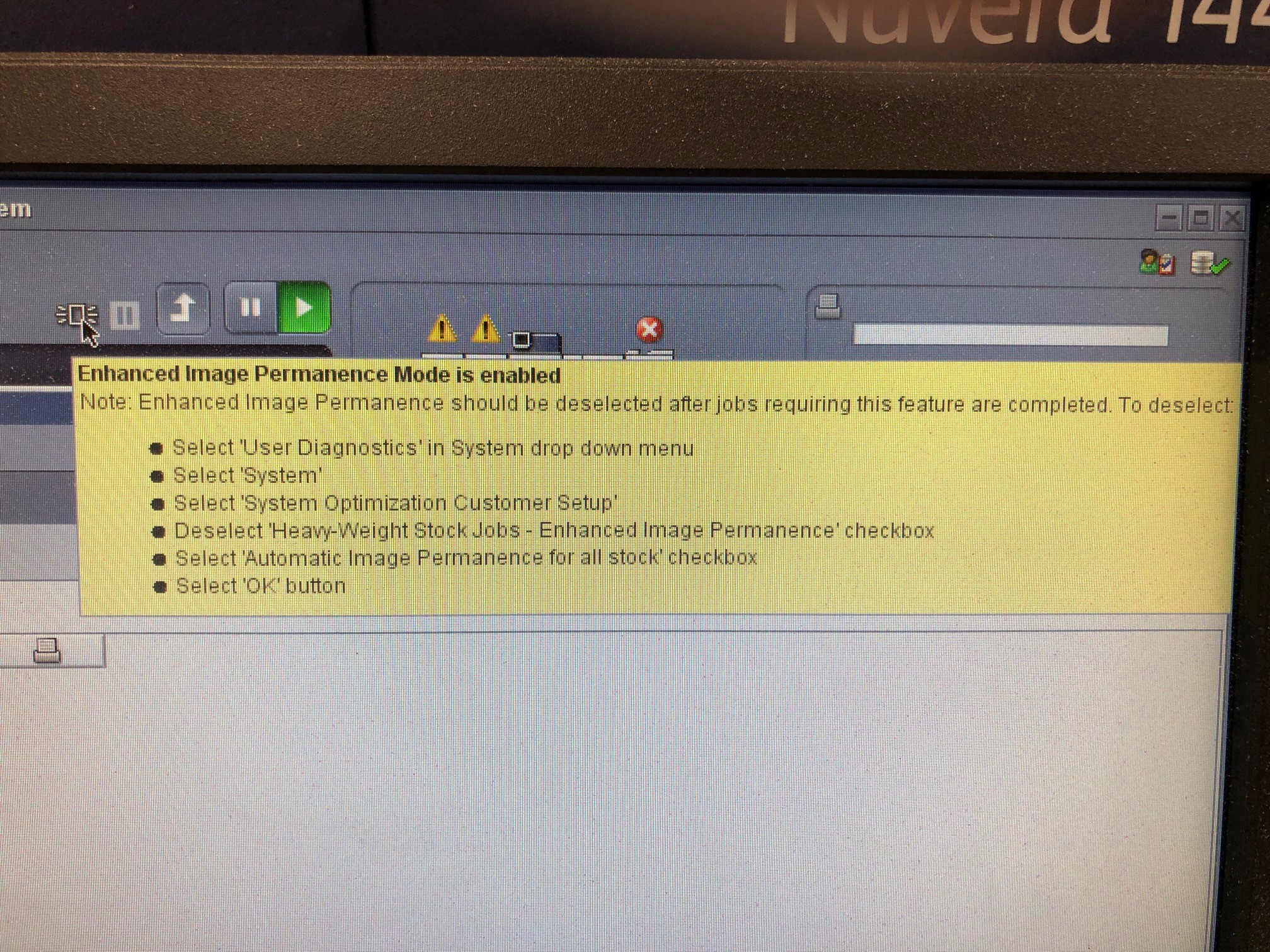

- try turning on Enhanced Image Permanence (see pic). This is intended for heavy stock but I leave it on always to help with fusing as I run some heavy coverage. I believe it increases the fusing temperature

Yes, the trays are being programmed for ordered tabbed stock. They are plain uncoated stock. I will check with the techs next time I see them, and we definitely haven't been using Enhanced Image Permanence, will definitely try that.
