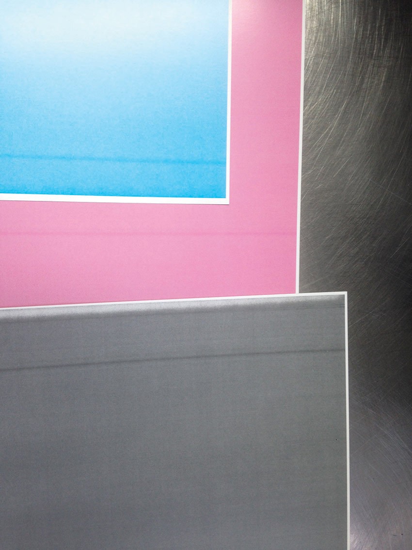

4 months into using our Versant 80 I noticed a dark vertical line appearing in the tint areas of a job I was running. When an Engineer came round to have a look, I was told that it is one of the faults of the Xerox Versant 80 (see images attached) and that there was no way around the problem. I never had this on my Xerox 700 and find it strange that this has even been allowed to happened which means I can't run any jobs which contain a tint on the sheet.
Xerox created a fly wheel to minimise the problem but it still doesn't do anything when running heavier stocks.
I printed a CMYK tint test and found that the line is in a different position on each colour.
Does anyone have any workarounds to clear or minimise this problem which is caused when the sheet is fed from the tray and comes to a halt at the 2nd BTR.

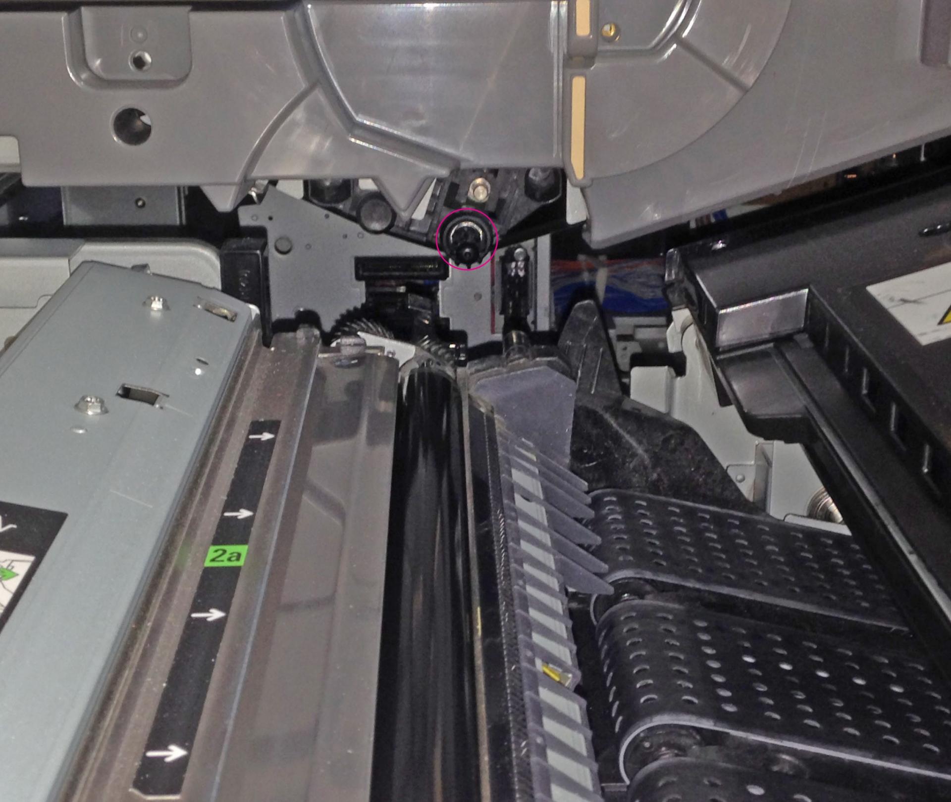

I had a look inside my Versant 80 but wasn't sure which part you was refering to.
I have attached a pic of the inside area. Is it the part with a circle around it.
If it is, do you know what am I supposed to do to it.
Stickman42
That is the part I'm referring to. My tech has seen this crack or break off a tooth and cause the dark lines you're seeing.

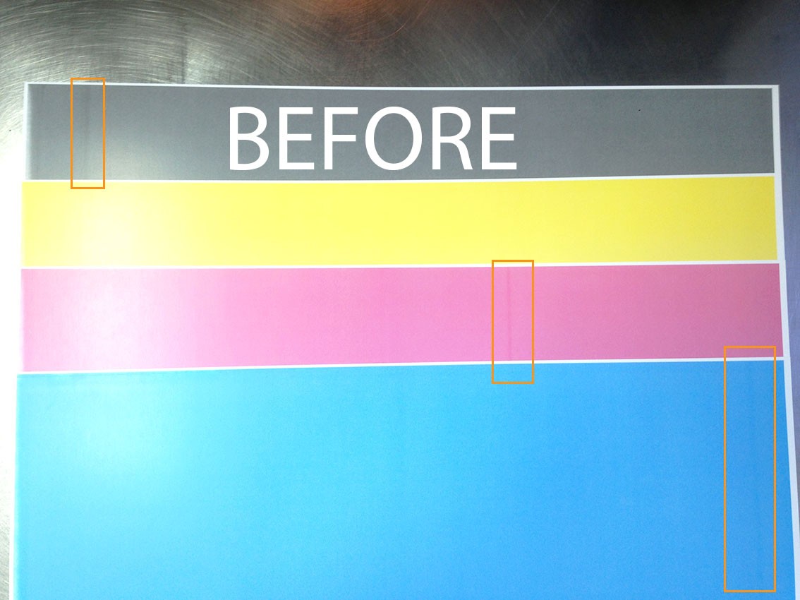

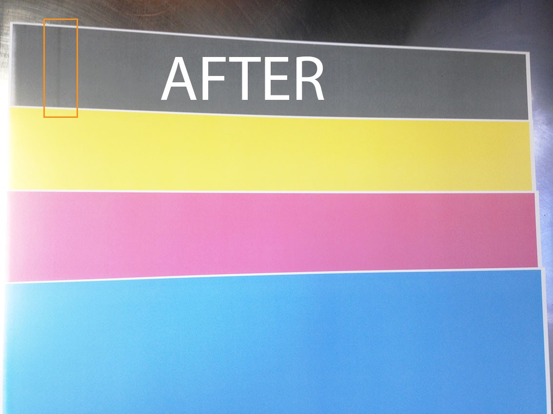

Right...here we go!!!!!
Before and After Pics attached (Lines are darker on the actual sheet - the camera didn't show it up clearly).
Had an engineer round for 100gsm uncoated creases (it was the fuser) and whilst he was round, I showed him this forum...he did laugh at some of the comments but said exactly as Rory did. Anyway he also showed me a solution WHICH WORKS!!! (But only on the Cyan, Magenta and Yellow). He also said that black was the last colour to lay down and there is no way round having lines on Black.
What he did was slow the machine down so that the heavier sheets don't come to a sudden stop and knock the machine and cause as much of a judder.
Login as Admin > tools > maintenance (1 click down in the features menu on the right hand side) > NVM Read / Write > Chain Link 740-492 - Confirm > New Value - 1 > Save > Close > Close > Device Information > Reboot Now (this will not click when pressed but the Versant will reboot)
The machine will run at a much slower speed but at least it is a work around.
When you have run your job and want to reset back to normal speed go back into the above but change the New Value from 1 back to 0 (1 = Slow Speed, 0 = Normal Speed)
Anyone else who tries this, please let me know if you are successful.
