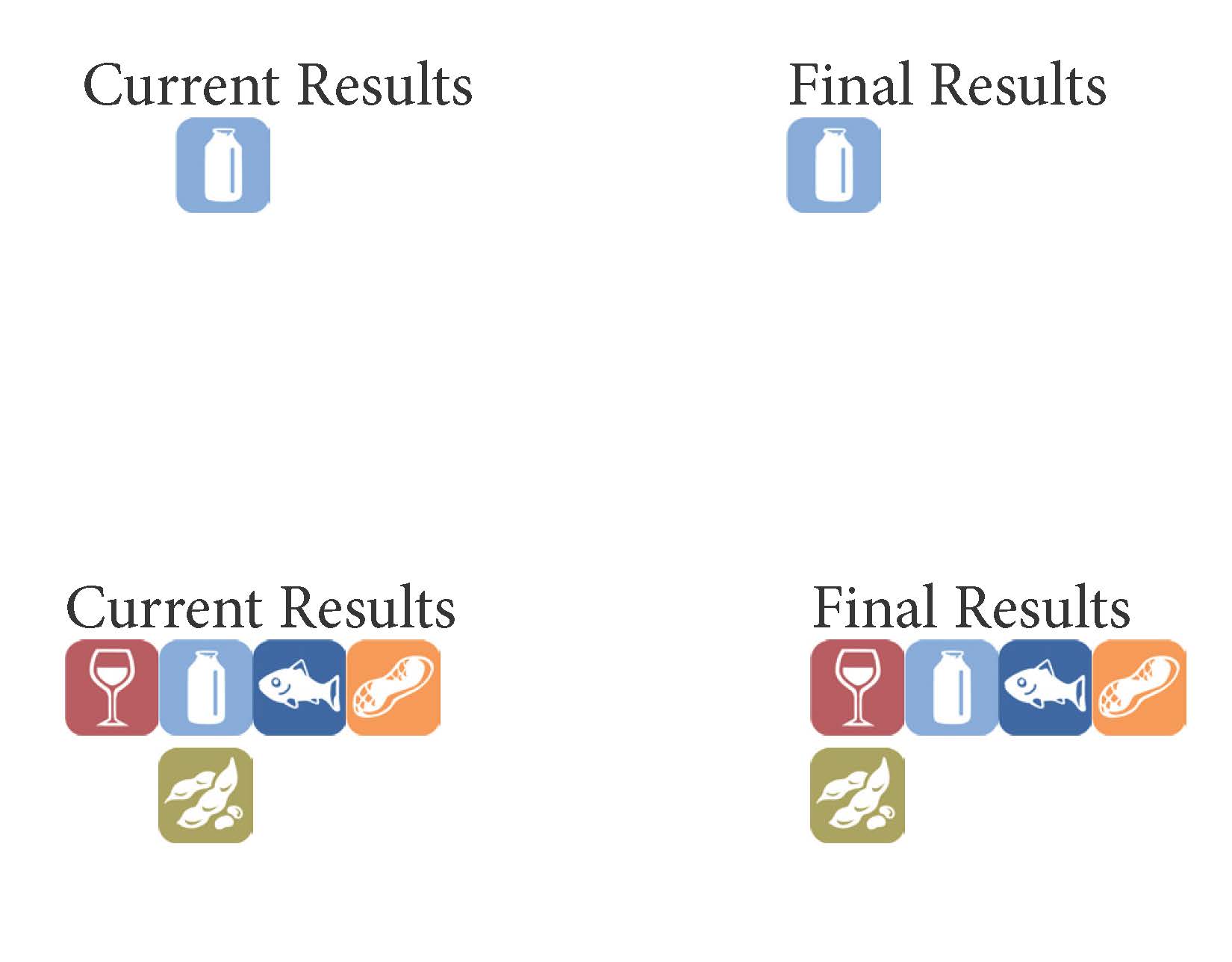

My apologies as it may be easier to show you rather than explain. Please find attached a Sample.jpg file showing Current Results (what happens now) and Finish Results (what I want to see). Sample.jpgLet me know if this helps clarify what I am trying to accomplish.
-Greg
My apologies as it may be easier to show you rather than explain. Please find attached a Sample.jpg file showing Current Results (what happens now) and Finish Results (what I want to see). View attachment 3627Let me know if this helps clarify what I am trying to accomplish.
-Greg
the best way that I can see to do this will be a bit of a mess of QLingo, but possible.
you have graphics A, B, C (we'll stop there for now)
here is what you're going to want to do for each graphic box, now this is assuming that you ALWAYS want them to go in the same order, and that graphic A will never be in the second box, etc. (this is not proper QLingo format, if you need that, you will have to wait a bit for me to get down to that Comp, to figure it out.
Graphic Box one:
If FieldA = 1 (place A.tif)
else (If FieldB = 1 (place B.tif)
-> else (If FieldC = 1 (place C.tif)
--> else (Place Blank.tif)))
Graphic Box two:
Graphic Box Three:
It's not super elegant, but it will get the job done. Once you create the stacked If/else statements for the first one, just strip off the outer set for each successive box. Hopefully that makes sense.
--> these MUST be nested like this, not just if/else if. nested like this, it will either place the first graphic and ignore the rest of the script, or fail and move to the next statement. if you do not nest them, the script could behave unpredictably if more than one statement is true.

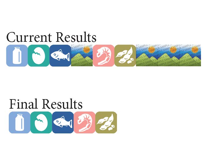

Ok. I've tested the variable image method and this is quite close to what I want. However, I still get blank boxes in places the data is empty. Please see attached Sample2.jpg.
