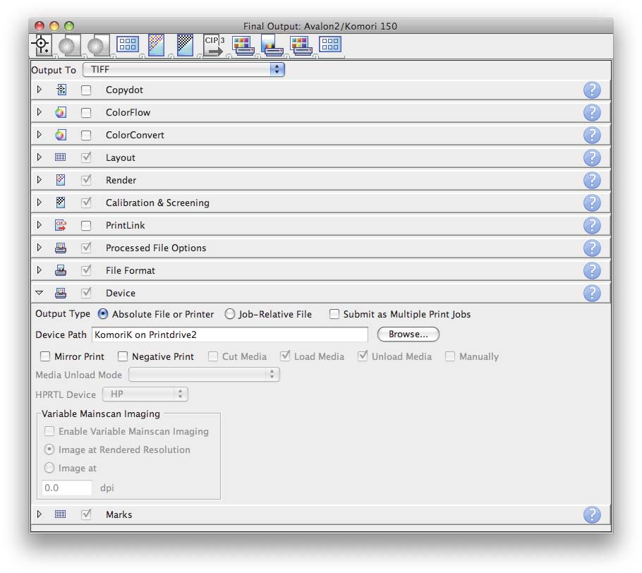

I work for a company that is going to use Prinergy Evo to drive an Agfa Avalon N16. We currently have a Magnus 800 and everything was all ready setup when I came to this company. We do not have a contract with Kodak and they want $$ to answer this. My question is does or can Prinergy Evo create a 1-bit tiff file that can be sent to a satellite computer hanging off of the Agfa platesetter that will be installed. I think the satellite computer will have printdrive on it.
We are running prinergy Connect and do this. I am not sure if the tiff output was extra or not.

Thanks for the reply. Right now under our Output To we have print to device selected. When I change this to tiff, I do not get the same options that you have. I am starting to think that this is an option that must be purchase. Thanks again.:)

This depends on license, try changing the "Output To..." to TIFF in Output Process Template.

One bit tiff (for export) is licenced option.
bets are you have the licence.
Check witch licences have at your rip, to check you have one bit tiff export.
If this is the case, you have to configure nework directories so both machines will work toguether.
That is it.
If you do not have experience to configure evo, will need some technician to help.
