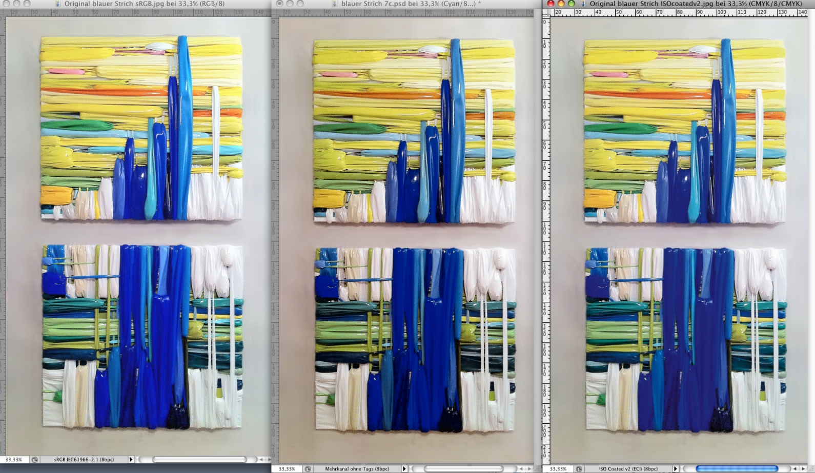

For illustration is here a download with the "original" as an example for difficult blues and screenshots of the bitmapped preview - i hope, that dropbox works:
http://tinyurl.com/hwf6tow
By thinking to satisfy a customer with difficult blues in his RGB-Original for Offset on coated sheetfed, it is a short way to think about higher color gamut to get closer to the RGB original.

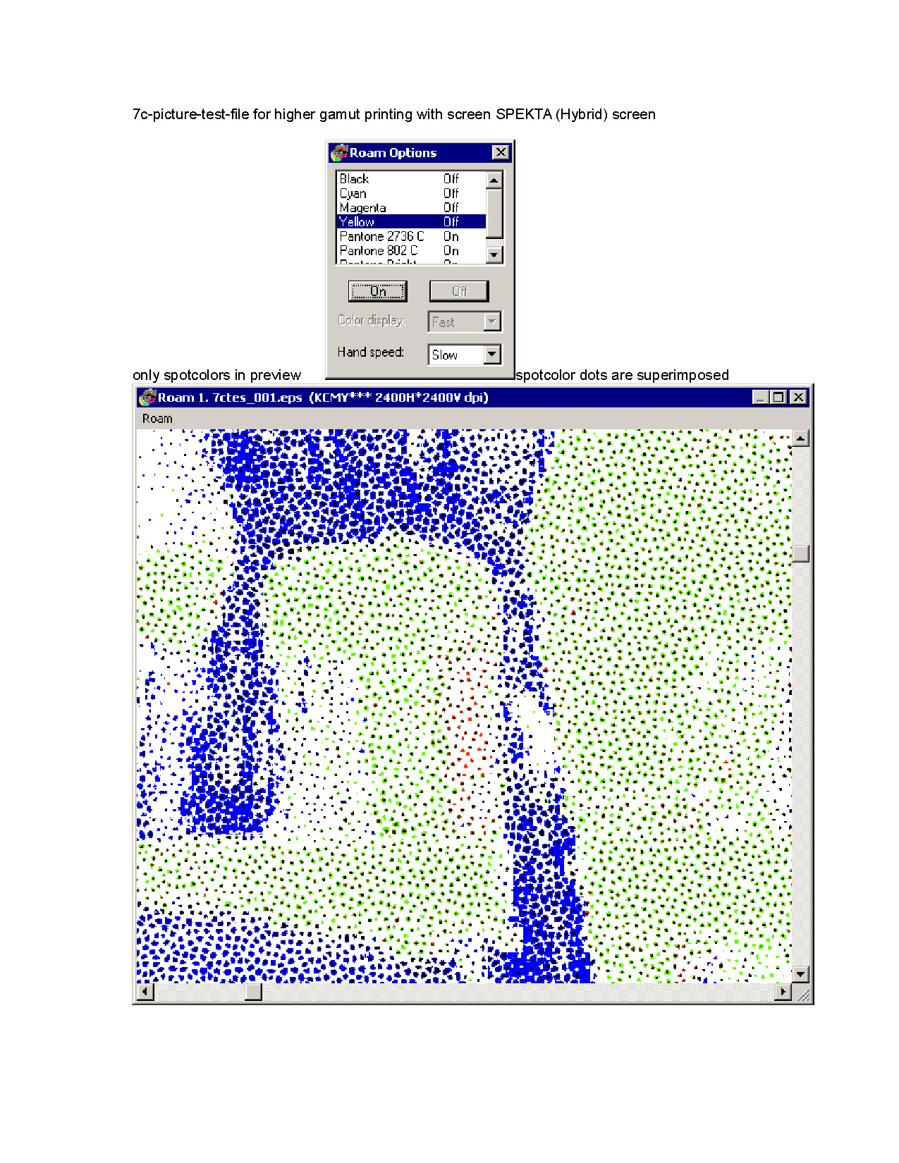

But with SPEKTA(I) there is a problem:
The separated Spotcolor channels are bitmapped with dots which lies exactly one above the other and that will cause no stable run, because the risk by a slightly different register is high...
(by the way: may be this is the reason for calling SPEKTA a hybrid, because the dot size is diferently as to see in the screenshots and not only the frequenzy as by trueFM/NP(non periodical)?)
I think: Channel mapping the spotcolors to a complementary color could be an idea, but that would not be very smart to handle (spot Green to magenta, spot Blue to yellow and spot red to cyan).
Any ideas or knowledge how to face this very special challenge are welcome, also recommendations for an other color space and profile for more satisfying the RGB-blue?

1. AFAIK Spekta only has screen patterns for 4 colors. I've never seen anything from Screen that suggests otherwise. You'd have to contact them directly to find out why. Other vendor FM screens have patterns for more than 4 colors.
2. What is your concern about channel mapping the spot colors to a complementary color? You said it wouldn't be smart. Why not?
3. RE: "may be this is the reason for calling SPEKTA a hybrid, because the dot size is diferently as to see in the screenshots and not only the frequenzy as by trueFM/NP(non periodical)" In a First order FM screen individual pixels are added pseudo-randomly within the halftone cell simulate different tones. Spekta, like the vast majority on FM screens in use, is a second order FM screen. To simulate different tones, a second order FM screen like Spekta pixels are clustered within the halftone cell to form larger structures. This growing of the dot is what makes 2nd order FM screens hybrids.
4. I wouldn't use a profile to do the separations in your case. I'd just create the extra channel for a Blue printer where needed in PhotoShop.
5. Doing the extra channel(s) in PShop will give you a fairly good representation on screen for how the image will print. The RIP driving your ink jet proofer may know how to handle the 5/C separation (The most recent I did was a Canon proofer driven by an EFI RIP - it did an excellent job showing the difference between a 4 and 5/C separation.)

I don't know about your RIP but typically there is a screening cycle. So the RIP starts with KCMY then cycles through KCMY for the spot colors. So: KCMY Spot 1=K, Spot 2=C, Spot 3=M, Spot 4=Y, Spot 6=K, Spot 7=C and so on. Some systems have specific screen patterns for the spot colors - a much better solution. That was the case with Staccato the screening I worked on. You need to find out from your RIP vendor how it handles this problem or you will need to use a workaround. I.e. RIP the spot color separately as a color that you want the screen to be. E.g. Take the grayscale of the 5th color, colorize it as Yellow then RIP it. The RIP should apply the Yellow screen pattern. Then bring than bitmap into your work flow.

I´m working with a very old Version of a Harlekin RIP (v. 5.3.1) in which is the SPEKTA I modul is licenced.
Unfortunately there is no "cicle" according the sequence of cmyk and spotcolors and the "funny" thing is, that all spotcolors are bitmapped with the pattern of magenta. It does not take any effect, if i try transparency or opaque instead of normal in the Harlekin-RIP-dialog or if i change the sequence of the cmyk-channels from KCMY into KCYM.

RGB 7c ISOcoated.jpg - Click image for larger version  Name:	RGB 7c ISOcoated.jpg Views:	1 Size:	1.04 MB ID:	259057
Thanks for reading! (and don´t respect the graybalance...)

To work with a profile for a 6 or 7 colored gamut is also obvious, when more pictures are to optimize than only one, or not? But of course you are absolutly right, that also the softproof preview with a 7 colored profile happens with the deposited Lab-values in photoshop.
If you have a good 6 or 7 color profile (e.g. one that preserves neutrals and single colors, etc.) and you're doing a lot of that kind of work and the ink colors you use are always the same then a profile might be a good idea.
However, you do not need a profile to do 5, 6, or 7 color separations. Doing separations without a profile gives you much greater flexibility in choosing the extended gamut inks you use and where in the image they will be applied. I know of one commercial 5, 6, or 7 color separation that does not use a profile and that does a very good job at automating this kind of work. But for once in a while use I prefer to do it manually in PhotoShop.

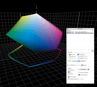

The difference in gamut between AM and FM happens around 15% and 85% and is largest around the 40-60%.
In a 4/C separation the third chromatic color always greys (reduces chroma) of the other two chromatic colors. So, if you add Yellow to an M and C screen tint - the Y reduces the chroma of the M and C patch. That's the idea behind doing GCR - instead of using a chromatic color like Yellow to grey the M+C color, use Black instead.

Gordon, I know you have stated similar comments before. I think there is some kind of problem with the logic but it might only be semantics.
On one issue, I would say that coarser screens would have fewer not more spaces between the dots but those spaces would be bigger.
In my view, Gamut size would only be related to the size of the outer surface of the mapped Gamut volume. Any point within the Gamut is not a gamut increasing issue. So just because some combination of screens have a different colour in FM and AM or when applying GCR, it probably does not have anything to do with increasing gamut unless it is on the gamut surface.
My basic view, which could be wrong, is that the primary determination of Gamut size is the solids and the overprint of pairs of solids. Difference in screening might have some affect between these points. But if one talks about screening of more than 2 sets of screens, the the resulting colour is within the gamut space and should have no affect on gamut size.
On the issue of the light hitting the unprinted paper, I understand your point about it greying the colour but I would argue that it has nothing to do with the potential of the Gamut. Any potential gamut would be related to the resulting colour of the actual dot itself, which is closely related to the solid. Also if you have a solid and you want to lighten it, you need to have a screen which allows the reflection of white light. And yes, doing that does grey it in the technical sense but if that is the colour you want to get then that is what you have to do. If you want an increase in gamut of that screen, then one has to go and increase the gamut of the solid.
I might be wrong about a lot of this because it is a bit hard to think in terms of where on is in a gamut space for any combination of solids, screens etc. :)
If I understand you correctly, your thinking about the gamuts is similar to what GATF's was in 2003 when they did a study (by Gregory Radencic) of FM screening and presented their findings in a research and technology delivered at their annual tech conference. They stated that the gamut was determined by the solid ink densities. Therefore they didn't look at the gamut volume itself.
I, and some of my creo coworkers formally protested about the methodology used in evaluating the screening technologies. Also, their conclusions about gamut contradicted studies from other print technology organizations as well as what the various vendors of FM screening were saying.
So GATF redid their evaluation (this time by John Lind) and presented their conclusions at the tech conference the following year. In that report John now found that the FM screening had an 11% greater gamut than the AM screen. John did not really speculate as to why that would be so (the gamut question was not the main focus of the study).
The mechanism for why FM exhibits a greater gamut is still a matter for speculation. The research that we did at creo pointed to the difference in the amount of light reflecting off the uninked paper being the primary cause. I believe that a TAGA paper suggested that it was the difference in ink film thickness homogeneity across the surface of the halftone dots that is the cause. I don't know.
What I do know is that if the SIDs are the same and the tone (density) values are the same then, for example, the color of a 50% 175 lpi AM screen will not match the color of a 20 micron FM screen. You can make the FM patch match the AM patch by greying it with black or C+Y but there's nothing you can do with the AM screen that will allow it to match the FM (except increase the AM lpi of course). I.e. the 50% FM patch is out of the AM screen's gamut. And if you profile the two screens you can see that the FM gamut volume is larger.

Better would have been i had awsked: Is it with FM possible to reach a color value out of the AM gamut with three colors or two colors and black?
I had posted a (worse) colorthink-3d-gamut visualized picture with the profiles ISOcoatedv2 and PSO_Coated_NPscreen_ISO12647_eci before. The first is AM-gamut the second FM-gamut on the same papertype, both Separations with a TAC 330% in the deep black. The bigger gamut NP-(Non Periodical)-Profile is transparency, so that you can see the bigger gamut area compared with the AM-Profile
You wrote before:
The extra gamut only applies with one and two color screen tint builds.
so, that means, the visualized difference shows color values they are caused only by tonal values of primary and secondary colors (y+m, m+c, c+y)? On the first look it seems that all differences happens above the edges (pinks?) of the solids and secondarys, but below the Cyan and green edges (pinks?) is a very small, but an area. The areas below the edges but must have either a third color or black and i think it doesn´t matter if you gray a secondary color with a third or with black in this context. But as you said already, it is not remarkable.
(By the way: in numbers color think points out for the NP-profile a volume 425.358 and for the AM 402.279, so the NP is 5.7% bigger than the AM, and that is, but not very much bigger.)
I don't think so. At least in practice vs theory.
When GATF tested 133lpi vs 25 micron the calculated number of one delta E cubes for the FM color volume was 389,556 vs 350,395 for 133 lpi - an 11% increase in gamut volume. Your mileage may vary.
