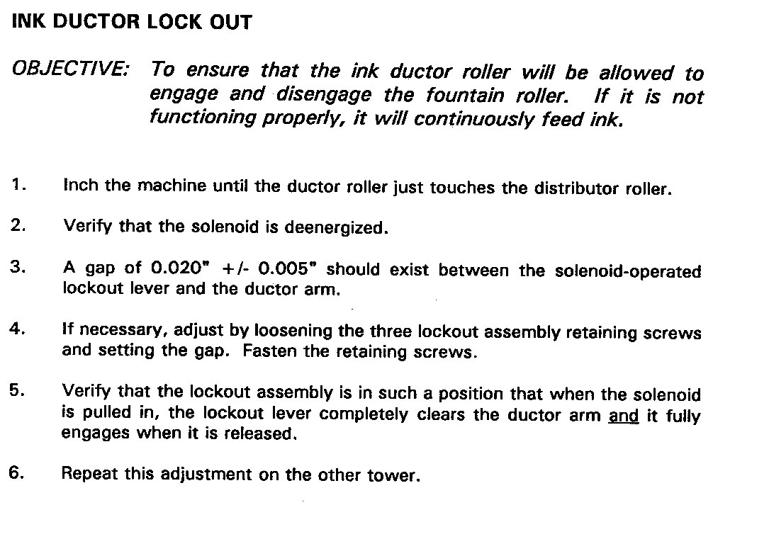

Options are switch the solenoids from tower to tower. If the problems follow the component than you know what to do. If the problem remains verify all mechanical parts are free moving on that side, pay attention to the levers on studs. I had one stud where it was loose and would cause the ductor roller to move. The plate the solenoid is mounted to is adjustable also. I also had one C3000 one tower 2 where the wires come up the side frame to attach to the solenoid where pinched from the side cover making it ground sometimes.
Solenoid info
A-253381 SOLENOID ASSEMBLY (SOL) $103.25
Printers Repair Part
