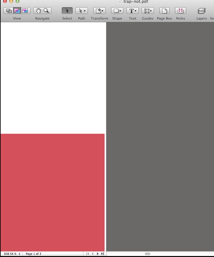

If you look at the file with a good PDF editor like Neo and really zoom in you will see the small gap's. See attached screen shot

This is a small gap issue.. If you have the other job we can look at it also.

Had another one today - this time I tried "Detect Small Gaps" and it did the trick.
So, is this something that most Nexus users leave on as their default? Are there any possible unintended bad consequences?
I leave it on. It will slow down the trapping a small bit, but it is worth it. It will detect leaks that you cannot zoom in close enough to see in programs like illustrator.
