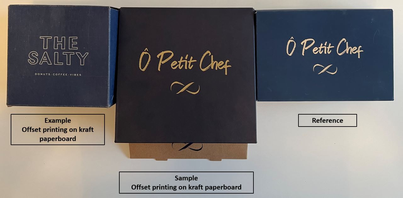

We did offset printing directly on a brown kraft paper board of 350G with a blue background in pantone 2767C and text on it in pantone 155C (flesh color). The rendering is darker than expected for both colors (see picture below the comparison between our sample and the reference). I know it’s doable to get a lighter color result as you can see on the picture below with an example from a competitor (left box on the picture). The color rendition of the Reference is obtained by digitally printing the artwork on regular white paper with Blue (#182D48) and Flesh (#F0D09F). We've tried digital printing with CMYK on the brown kraft paper and the result is even worse (very dark). Additional requirement, the client wishes to retain the brown color/authenticity of the kraft paper, that's why we print directly on it (and not on a white kraft paper).
Would you have any recommendations on how to get lighter colors (closer to reference) with offset printing directly onto brown kraft paperboard (i.e. add more layers of ink, use lighter pantones considering the existing brown color tone of the paper board, other recommendations, etc.)?

Three ideas:
1. Two hits of white ink dry trapped as a base where needed might help a little
2. (silk) screen opaque white as a base where needed
3. use white kraft and print the brown texture
Three ideas:
1. Two hits of white ink as a bse where needed might help a little
You left out one option.
Use a white ink base instead of the usual clear base to create a more 'opaque' color ink, ie add opaque white and remix accordingly.
This might be the one that was used on the sample.
Silver (Pantone 877) can sometimes be more effective that white as metallics have greater opacity
Both you & Sheetsqueezer are correct about underlay and dry traps.
But . . .
OP mentioned you could see the paper through the ink. I thought a mixed ink with a white base would achieve this with less effort.
YMMV.
Or maybe even silver, then white? On a side note, you should maybe consider changing your name to Magnus800, because of the most obvious reasons. 😆
Well Magnus is my name for this group, because I run a Magnus (400Q) while 59 is the year I came into the world :)
Adding opaque white to the mix has always worked out well for us. If the mix calls for white, substitute opaque white. If it doesn't, up to 5% in the mix can bring your color back. 5% being for darker material. Kraft 2%-3%.
Outsource to a trade/packing printer who has a press with an UV anilox coater in unit #1 to lay down opaque white first. Use a flexo relief plate.
If customer doesn't care about how the inside of the box looks, print on white litho wrap sheet to match kraft color, then emboss corrugate texture pattern.
Send the sample you want to match and the stock you are printing on to your ink supplier. They will create a custom match and will be able to teill you if opaque white is needed in color match or to be applied first.
Hello all and thanks for your answers, it's very helpful! I think adding 2-3% opaque white should do the job, I'll try. I scratched the Box Example and didn't see any white layer. Let's see, I keep you posted. Thanks!
