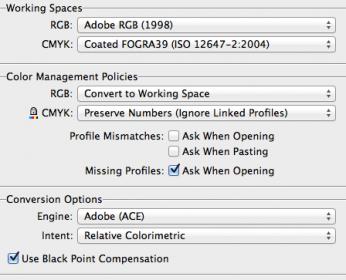

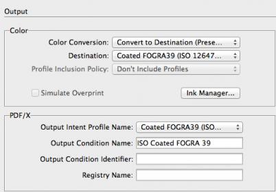

I'm having a hard time wrapping my head around what might be a very simple answer.
I'm working with a publisher who provided the following settings (see ColorSettings.png and ExportSettings.png). In both cases, numbers are preserved, so what are the benefits to converting to a Destination Profile? The same results would be achieved if you selected No Color Conversion, correct?
The only reason I can think of is to take care of any RGB images that may be present, which in my case there aren't. Any other reasons?

The RGB conversion is the only benefit I can see.
Which is not much of a benefit if the layout contains *vector* 0r0g0b objects such as black text or rules/strokes, I only see this as a benefit for raster RGB content.
Much better to use the colour conversion tools in Acrobat Pro or third party PDF Workflow software such as Kodak Prinergy, where one has control of creating 0cmy100K blacks for text and vectors instead of rich blacks.
So my advice (for those that know what they are doing) is to output from InDesign with No Colour Conversion to retain RGB content so that it can be intelligently converted based on whether it is raster, vector or text and if it is “solid” RGB black or a “tint" of RGB black.

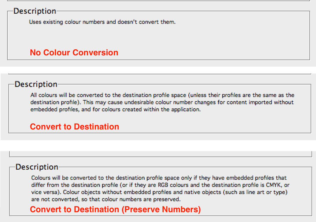

If you do an export with convert to destination it will change the CMYK values of a CMYK image or vector to the corresponding icc profile values, ie if you export with convert to destintation to uncoated profile it will change the CMYK & RGB values to that profile, best to leave it with numbers preserved if you dont want to mess with CMYK, preserve numbers will still give you a good CMYK output of RGB. And set it to the desired standard, ie fogra39, preserving numbers will let you change it to another profile without loosing the original color numbers (LAB).
Here are Adobe’s descriptions of what takes place (image attached).
If the layout contains *vector* 0r0g0b objects such as black text or rules/strokes, then it is best to output from InDesign with No Colour Conversion to retain RGB content so that it can be intelligently converted in Acrobat Pro - based on whether it is raster, vector or text.
If the layout only has RGB raster images and all native and imported vectors/text are greyscale or CMYK mode, then Convert to Destination (Preserve Numbers) would be OK to use.
I personally prefer to do colour conversions in Acrobat Pro, as the rudimentary colour conversion options in InDesign are good for productivity however they can lead to poorly created PDF files.
