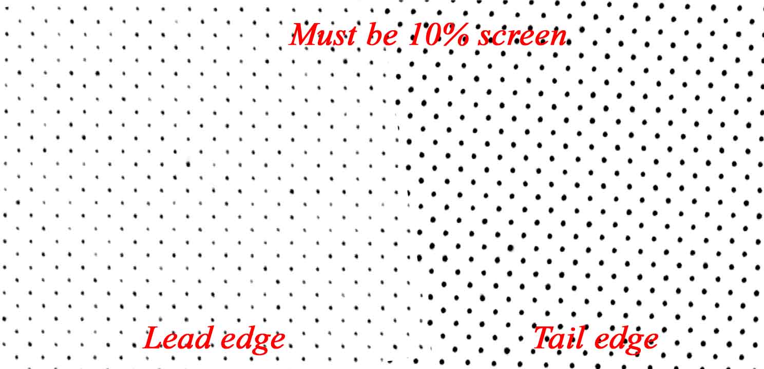

10% screen (on picture). Lead and tail edge.

You won't see much with 10%. Do a 50% grey test (or even 80) full area as advised because it will (mosy likely) rip as 45 degrees making artifacts more visible.
Just asking why do you measure density instead of percentage ? I have processed the picture you sent, they threshold as 6.1 and 2.6 percent respectively.

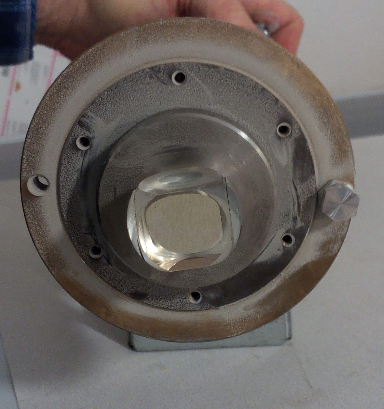

You guys are killing me..... The optics are dirty, it's a very common issue.
Just be careful not to scratch the mirror or lens.........
DonBlock, You are right!
The optic was dirty.
We cleaned it.
Density became uniform and higher.
3.6 (before) -> 4.6 (after)!!!

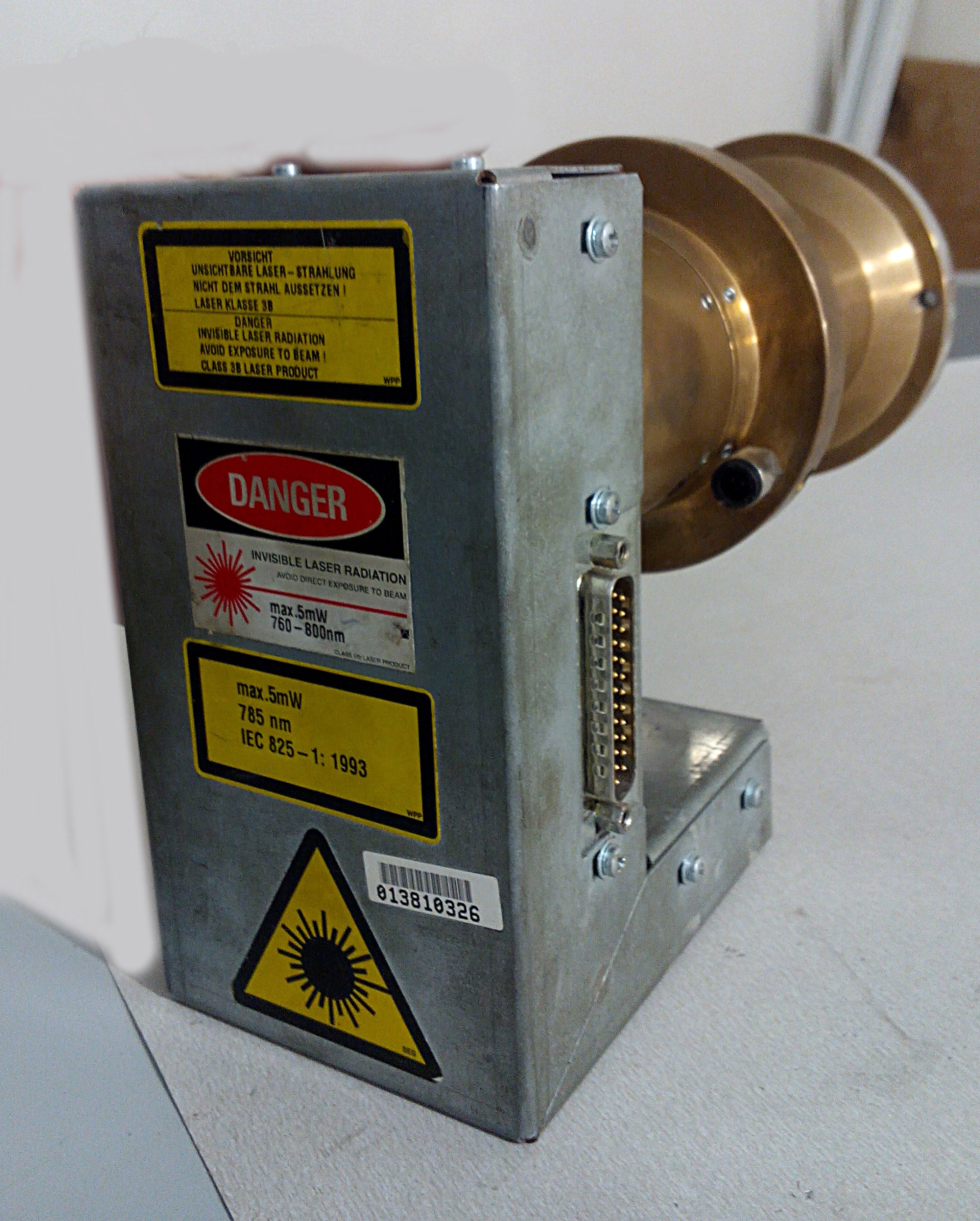

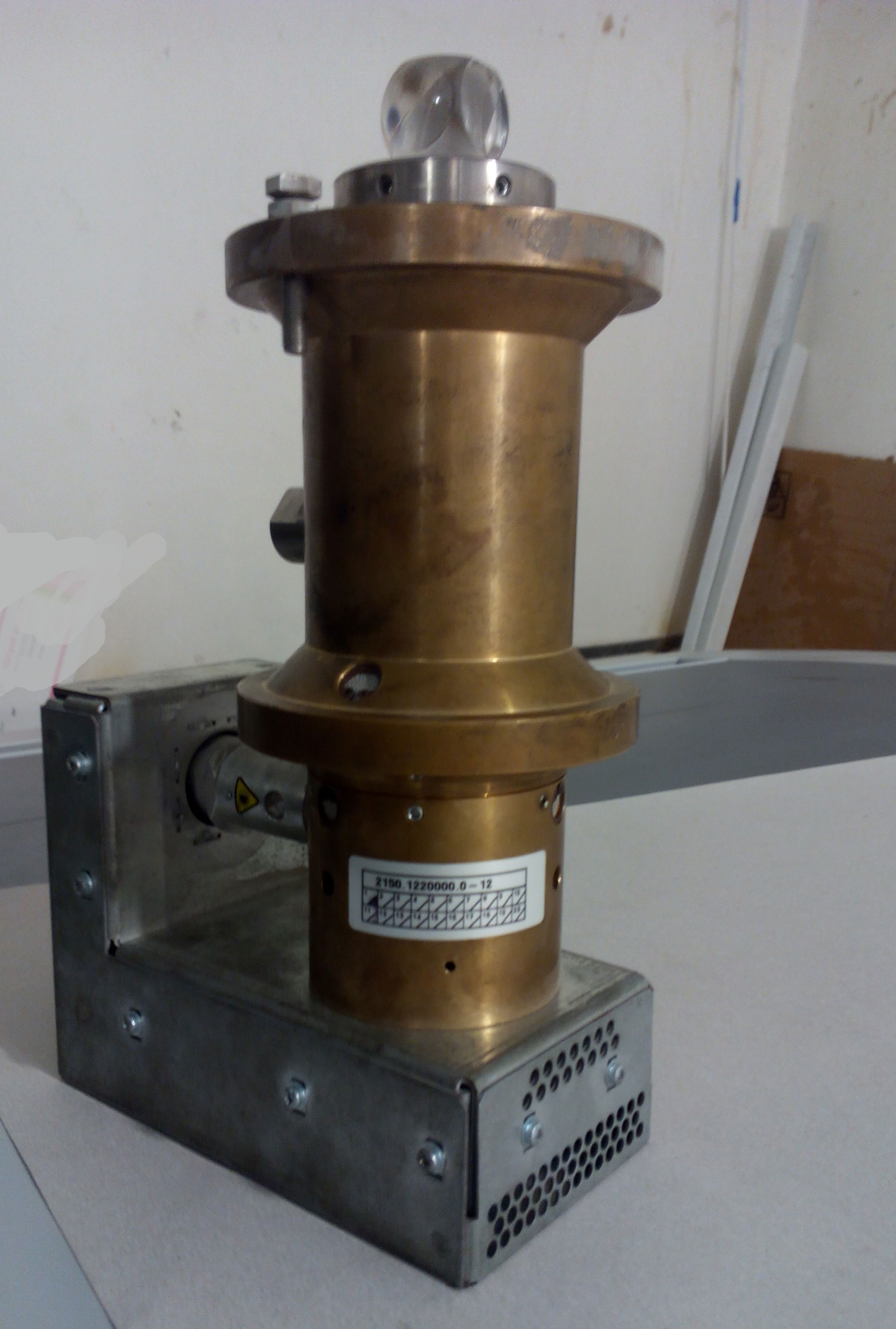

Dirty air bearings nozzles in laser head...
It overheats and makes a noise.
Can we clean them yourself?
egorus, the "air bearings" are actually Teflon pads that separate as the motor spins up creating a cushion of air for the motor as well as provide for braking when the motor spins down. I would not attempt to do anything with it yourself. You should look for someone who is qualified to work on that type of motor.
In Primesetter 74 installed Thermoelectric Cooler Tec 12703 30*30 mm.
It's right?
What are its electrical characteristics?
We have it crashes once a year...
