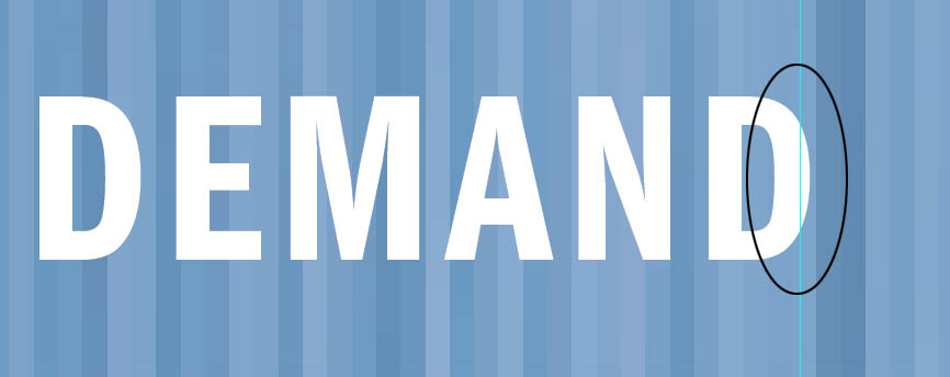

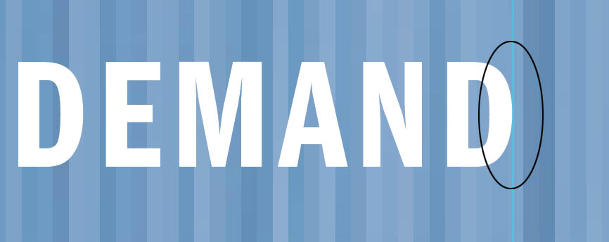

Here's one for you. This has happened with both the free version of Font Explorer X 1.2.3 and the trial version of Font Explorer X Pro version 2.5.2. Running on a Mac with OS 10.6.6. Type flows differently depending on whether you activate the font set before you open the file vs. opening the file and THEN activating the fonts.
Font is ITC Franklin Gothic Demi Compressed and it does have a tracking value of 60 applied in the character palette.
InDesign CS 5 version 7.0.3
It's a puzzler.

@Oxburger: you did see the whole word moved, didn't you so it's not the tracking within the word...possibly the space before the word? Just so you are looking for the right thing. If I find there are fonts that need activating I'll always close the file and reopen it‚ guess it is a habit. (I don't use auto activation)

We don't use auto activation either. Regardless of that, in an ideal world, it should be irrelevant of when the fonts are activated. They should work the same way, in all instances. Call me a dreamer if you want, but I want consistency. LOL.
:) ye what kind of fonts were they OTF? Some how it seems that there is perhaps an undefined character that has inconsistent width …*you did see my note about all the characters in the dumps have been shifted.
