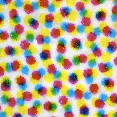

What is the quality of your ink transfer. How do the dots look under magnification. It would be great if you could post microphotos of your presswork's halftone dots.
best, gordo
Hey Gordo, we have our own density targets which we came up with as a standard. K = 1.60/C = 1.43/M = 1.32/Y = .92.
I would love to post microphotos of the dots of my press sheet but how do I do this? I have taken a digital camera on its macro setting and held this against a loupe on press and taken some photos. Will this work? I would really appreciate a critique on our dots!

All print shops should own a usb digital microscope as part of their quality control kit. They cost much less than $100. Here's a sampling from ebay: usb digital microscope | eBay
The one I own is a 20x-200x which cost me $75 in a brick and mortar store. Attached is a snap of halftone dots to give you an idea as to the quality (click to enlarge).
best, gordo
