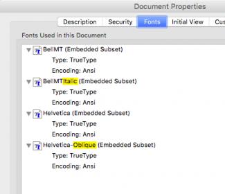

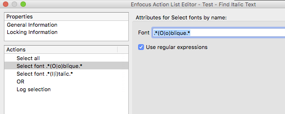

Enfocus PitStop Pro to the rescue, with it’s support for finding fonts using a regular expression:
props.png - Click image for larger version  Name:	props.png Views:	1 Size:	13.1 KB ID:	263599
[/COLOR][/FONT]
found.png - Click image for larger version  Name:	found.png Views:	1 Size:	8.6 KB ID:	263600
