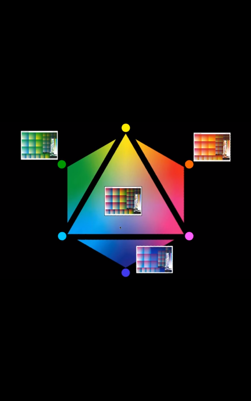

Bad colour math indeed. I don't believe any seven colour build should contain more than four inks at a time. You certainly shouldn't get any more than one of the extended inks in the same build.
The attached image shows a slide demonstrating how each extended ink is only required in the area of gamut that lies between itself and the CMYK gamut. (credit to Mark Samworth)
I could confirm that by flicking through the Pantone extended gamut fan deck but like everyone else, I never bought one. I do have some of the HP Indigo seven colour fan decks and I've never seen more than four in that one.
