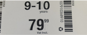

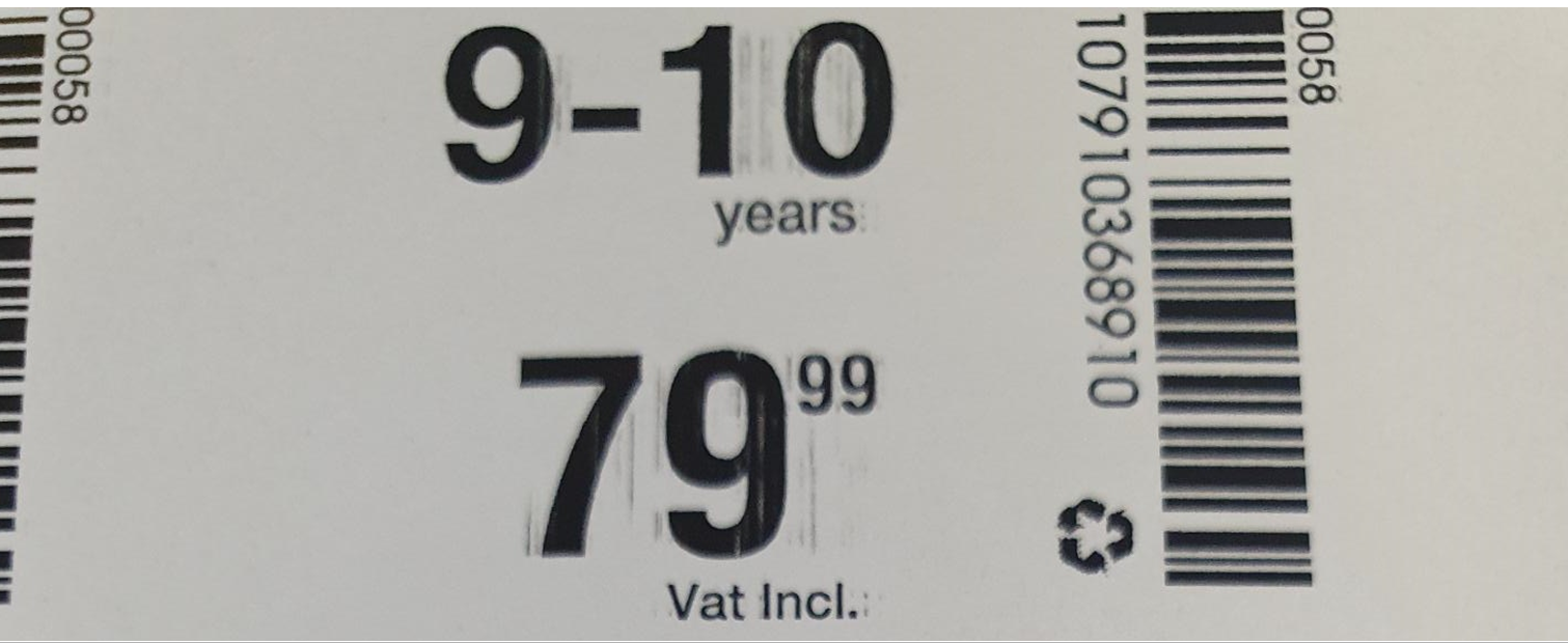

Good day Jwheeler. I trust u are well. I'm very curious to know if this problem with the 6136 black solid box issue printing with a ghost. I have a similar problem with my B6120 and any help at this point will be helpful. This machine has already done 5 million prints and the problem only recently occurred. I have an attachment as well. I wait for your response.

Just a reminder, lighter grammage like 80gsm is fine. The problem only occurs on the heavier stock like 200gsm upward. We've changed Dev, Tank, Drum, Charge. All of this never really resolved the problem. It made the print a little better but didn't completely resolve it.

Sorry, I haven't seen that issue on our machines. I'd suggest reaching out to your service techs. My only suggestion would be to make sure the machine is set to the proper gsm, or even 1-2 steps higher.
