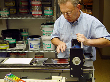

DRAW DOWN:
A draw down is a sample of an ink color, usually on the
STOCK that the client wants to use as their finished product. A
draw down can be used to create a special ink color that doesn't exist; it can be used to show what an ink will look like on a certain STOCK. It also can be used to show what an ink plus a clear COATING will look like on a certain STOCK or simply what the ink and clear COATING will look like when printed together.
Extending on what Cornishpastythighs wrote.
A draw-down is where the ink supplier takes a small amount of the mixed PMS ink and prints it using a table top hand cranked press called a "Little Joe" (see attached pic click to enlarge).
If a special effect is being applied e.g. lamination or varnish, then half of that sample draw down will have the effect applied. That way you can see the original color as well as what impact the special effect will have on the color.
That is probably what you are looking at and comparing to your swatch book.
A spectral comparison is where a special instrument is used to measure the spectral (light wave length) response of the pigments used in the ink. Since your supplier is using certified Pantone inks, doing a spectral comparison would be the last thing to see where the problem may lay. The other reasons given so far are more likely the problem.

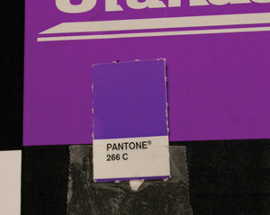

Can you take a photo or scan of the ink sample you have placed beside the swatch that it's supposed to match?

Thanks for all the explanations so far. I have added an image. Let me know what you think is the most likley culprint:
Ouch! PMS 266 :p
PMS 266 is composed of two inks: Purple and Reflex Blue
Both those inks are highly reactive to lamination which you're doing (and varnish). i.e. these inks shift color over time - sometimes very quickly but sometimes over a period of months.
A full explanation can be found here:
The Print Guide: How to subdue the Reflex Blue Blues
Your Pnatone swatch book is not laminated so it does not show the effect.
Another wrench in the monkeyworks is that they may not have used Reflex Blue when they made up your PMS 266. They may have used a substitute which does not have quite the same hue or spectral properties. This substitution is common in the industry because Reflex Blue has very poor print properties. It's a major problem.
You're in a big pickle with 266. You're going to have to rethink the ink color you are using, and find an alternative color that will work.
BTW The photo you attached allowed me to calculate the relative difference between those two colors. This is expressed as a DeltaE number. "0" is a perfect match, 2-3 is typical tight quality color match, 3-5 is loose color match and more than 5 is unaccepable. Yours is a DeltaE of 11 - no where near a match.
