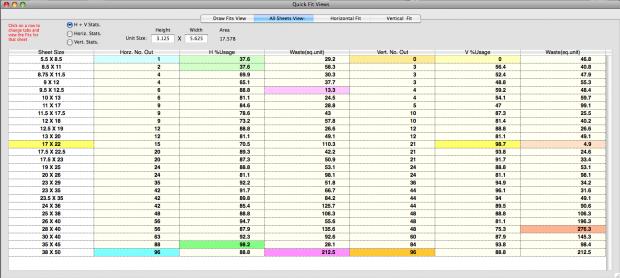

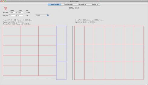

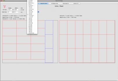

Quick Fit Views
Quick Fit Views
Here are three screen captures of the application window for my program.
Note from Picture 1 that the window has 4 Tabs and the default first tab is shown, where you can see the four inputs, the results summarized in text and the graphically displayed results.
Picture 2 shows the second tab displaying the inputs again and the chart of sizes in the customizable sheets list. Picture 3 shows access to that sheet list via a pup up in the first tab.
Al
Wish the pictures had better resolution Al.
Nevertheless, looks like this is exactly what Raj could use.
Regards,
Yoga
