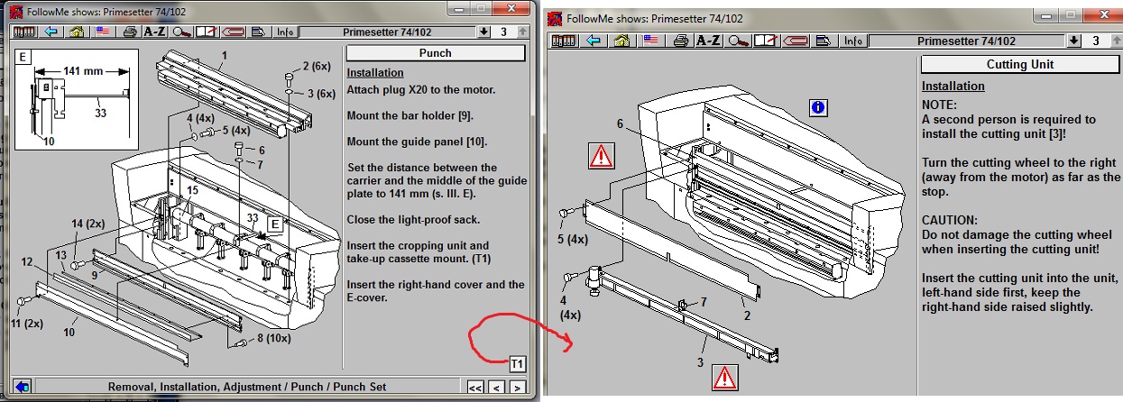

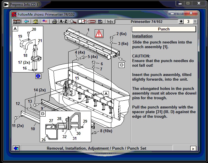

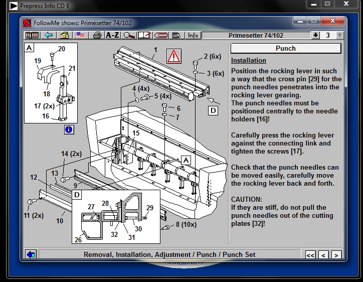

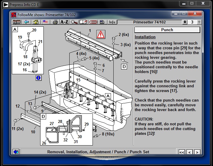

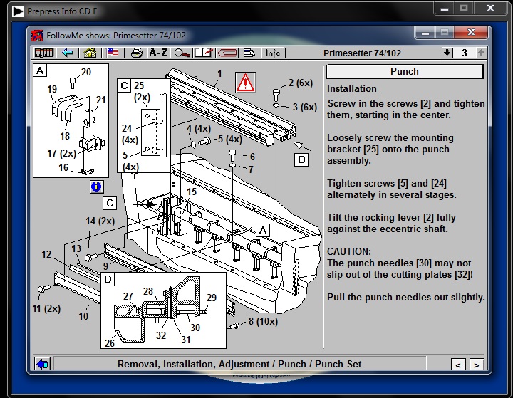

does anyone can tell me how to adjust center punch position in primesetter 74? - the center-punch was a little off center of the image. thanks
Follow the pages 1 to 6 for installation and alignment of center punch on primesetter 74.
Hope this will help!

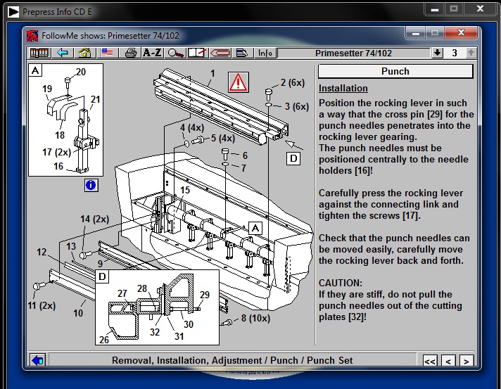

Enclosed please find the page 6 as attached file.
Hope this will help to resolve the issue! Good Luck!
