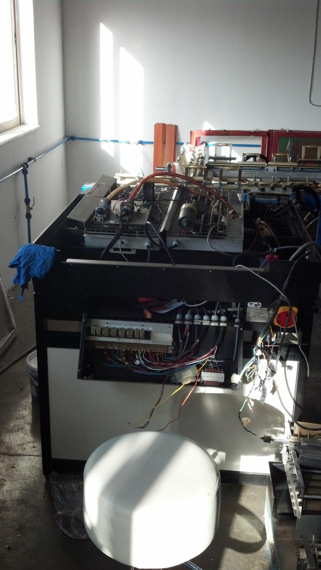

Not only do I remember I am actually half way through restoring an antique Glunz&Jensen to it´s former glory. However despite all the care in the world some of the little clips that tells you what wire goes where have dropped off, so I now have four wires and no clue as to where to stick them. Also at some point in it´s life the processor has had a rather slap-dash repair, so my question is: "Has anybody got a wiring diagram for a G&J PMR 660?"
I don´t know, a shot in the dark but perhaps one of the brethren or cistern has such a machine somewhere gathering dust or perhaps even still in production and can take detail pictures of the power and relais box under the dryer? That would help a lot. These machines were quite common in the nineties.

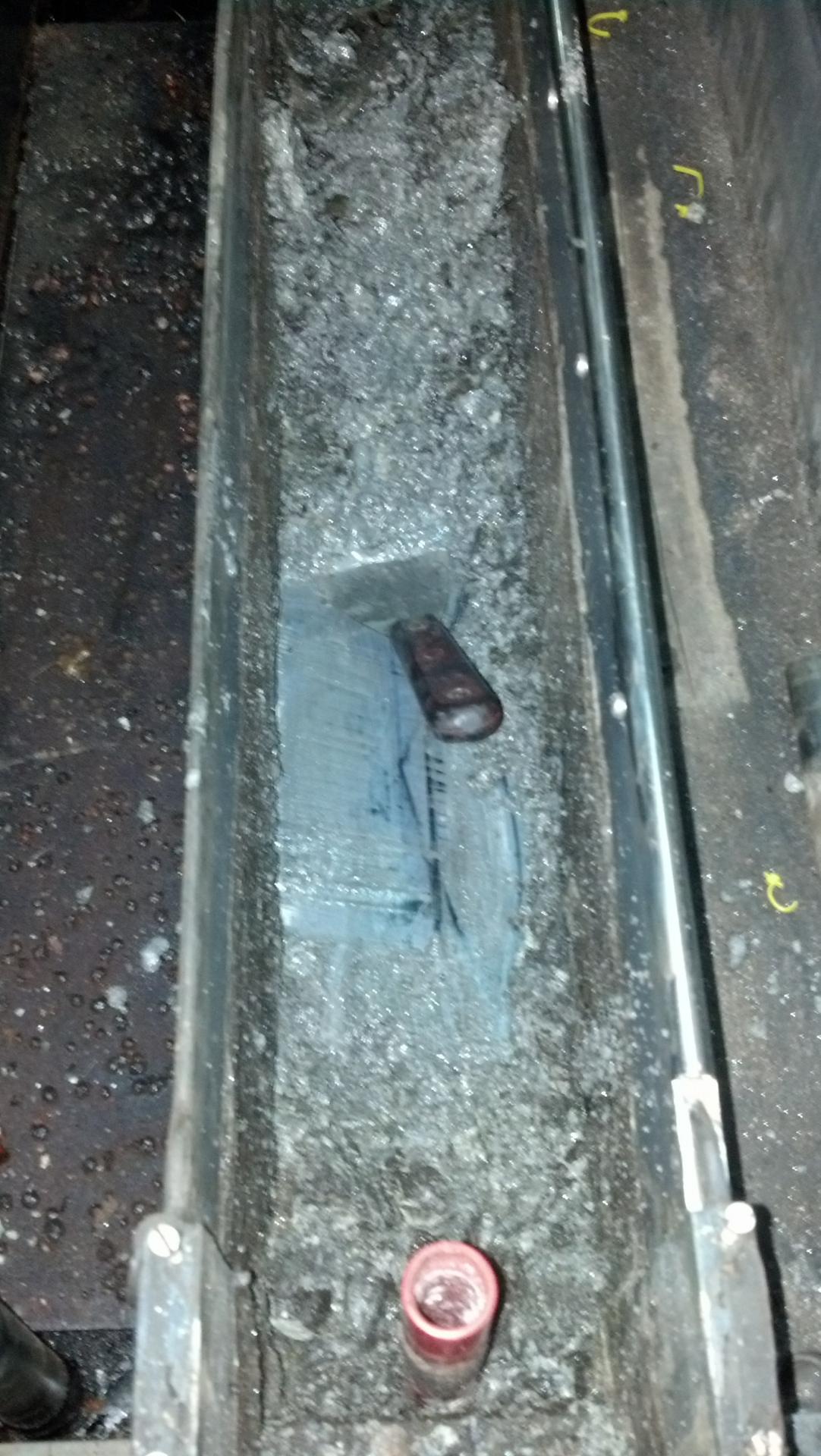

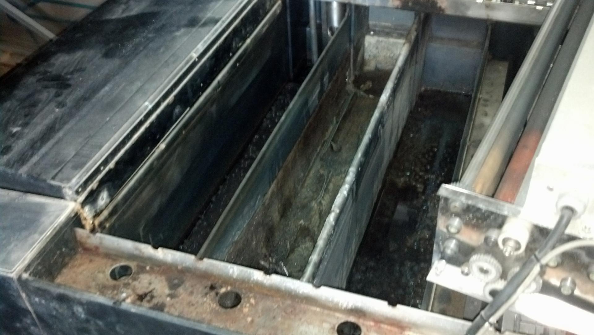

You are thinking waaaaaaay too modern. PMR660 is the tag on the serial number plate, on the cover it is called a "Powermatic R660" and the electronics and relays are in a box under the dryer, I will be posting a few before and after pictures and you can see the martyr-making suffering and anguish I have gone through.
Take pride, you are just like the guys that renovate antique cars or motorcycles.
Don´t know about that, more like the archeological excavation of a ancient midden, I still have the taste of dried chemicals in my nose.

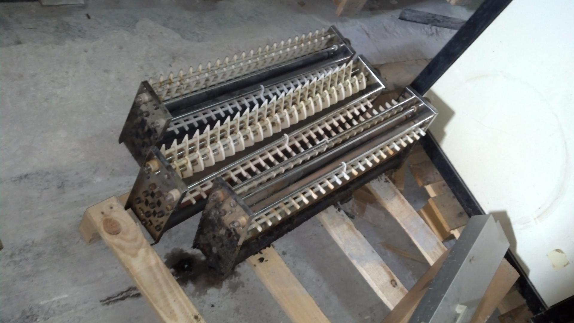

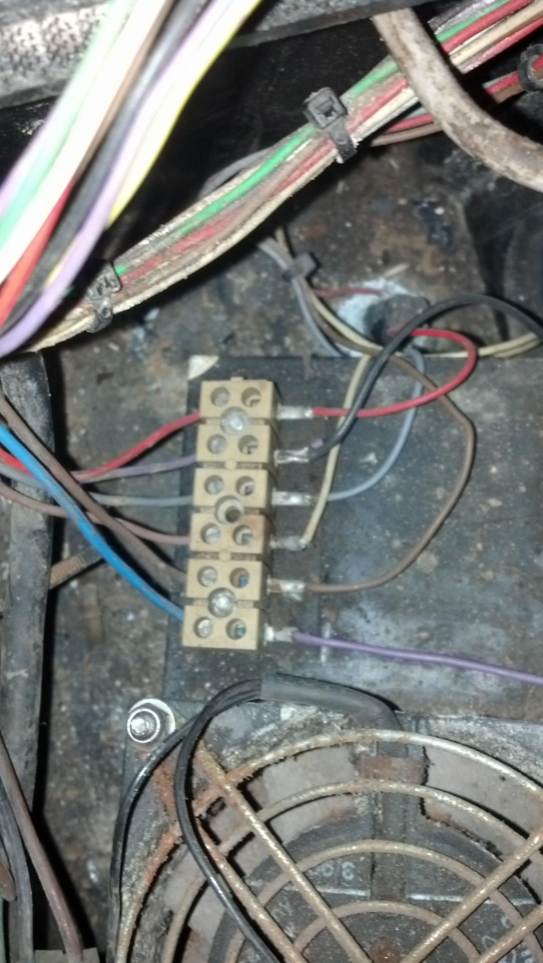

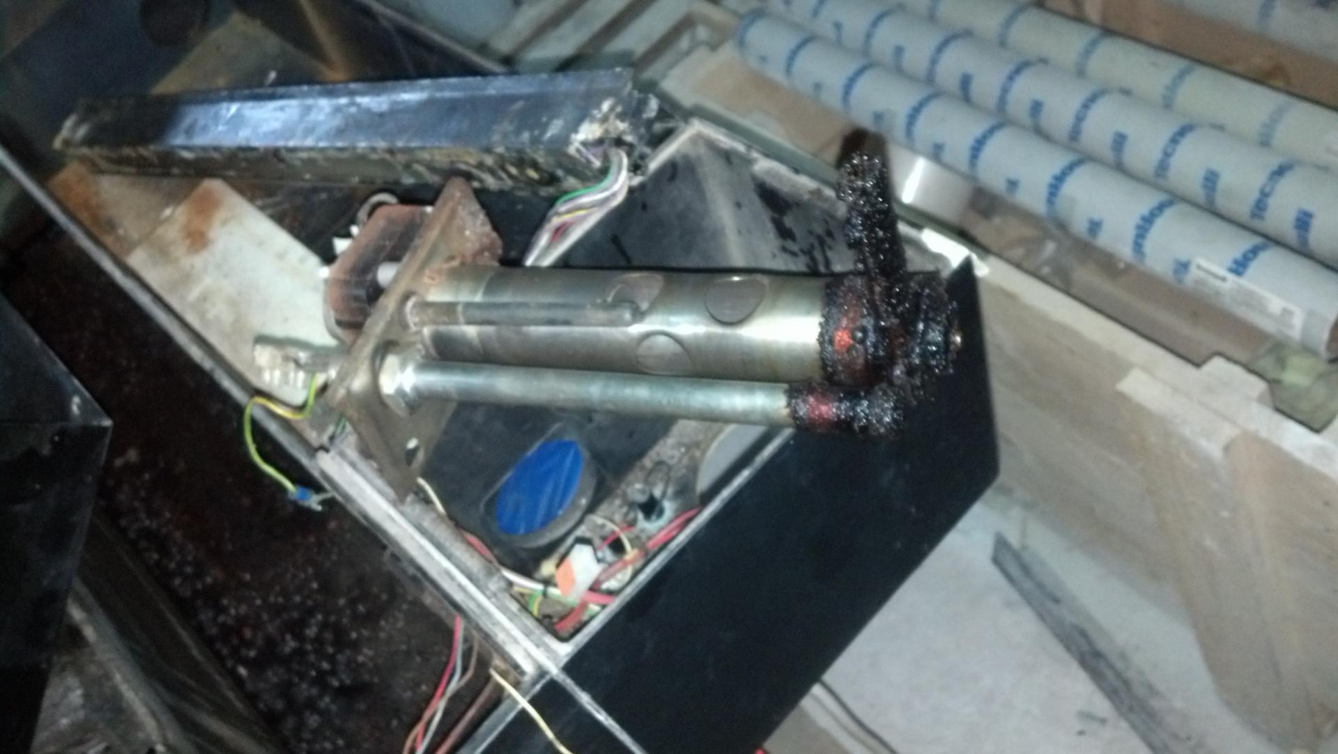

You are correct, the dev is deeper that the other two baths and now that you mention it I do seem to remember that "old" processors needed to run faster and I also seem also to remember that you could use a higher water to chem mix ratio. In the meantime a kind soul in Germany sent me a copy of the wiring diagram and I am working my way along the wires so to speak, at some point in it´s history the device has had a quick and dirty repair on the electrics and some parts are going to have to be re -wired. At the moment I am waiting for a new set of guides for the Fixer rack and a new set of stainless steel rack carriers. This machine is going to be a beaut. The baths are now clear, I had to chisel out the dried up chemicals and as soon as I got all the electric bits and bats out I chucked it into the van and took the whole unit, racks and all to the carwash for a power clean.
