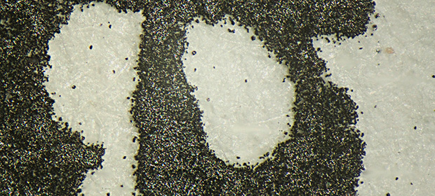

I just finished doing a bit of consulting at a direct mail plant. The toner from their laser printers was tracking and smearing on their sheeter-folder lines. This happened with only some jobs, and on those jobs, only on some of the paper rolls. That's interesting.
I did improve their bindery equipment and make it less abusive along the way. The toner-paper interaction problem demanded resources they were/are not willing to commit. However, it looks like the paper fibers on some rolls are more likely to break loose, and the toner stack with them. Too, they are using old equipment, reconditioned printer drums, and high settings to compensate for that, so the toner stacks are prone to breakage, anyhow.
As it happens, some paper is too porous, and some paper is not porous enough, kind of like Goldilocks' story. It's, well, a bear to deal with.
Here are links to some YouTube videos on this subject.
YouTube - web-ready DMS clips
YouTube - 2010_03_01_071753.mov
That letter "a" is 8 point.
