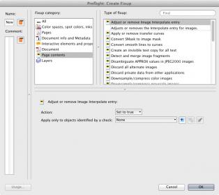

To change it with Acrobat, you need to create a preflight with a single "fixup." I've attached a screen shot of the fixup that gets it done.

It looks like my screen shot was downsampled and isn't readable. Surely nothing a little bicubic interpolation can't fix. :) Trying a different method here.

Hmm. Still crap. I've enlarged it by a factor of 2 (with nearest neighbor if that's okay).
Edit: no difference - the forum software is reducing to a fixed size apparently. Hope you can read between the pixels.

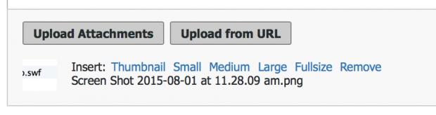

Kyle, the old forum software treated .jpg and .jpeg extensions differently allowing a large pixel size on one but only a smaller pixel dimension on the ohter and forcing a resize, as well as other formats such as .png etc. Looks like the new forum sw has different options.
