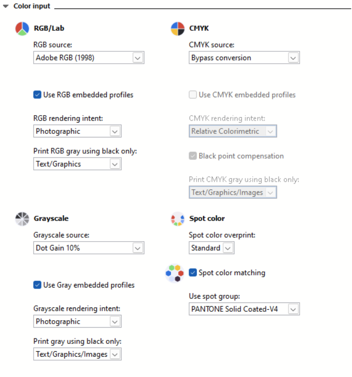

What settings are you using for Color Input in Fiery?
tngcas
For those of you who are using Fiery, what are your default settings on this screen and why did you choose them?

I would use the following settings:
RGB:
RGB source = sRGB
Use RGB embedded profiles = Yes
RGB rendering intent = Relative BPC or Perceptual (depending on the printer profile, papper etc)
Print RGB gray using black only = Off
CMYK:
CMYK source = Your preferred house standard
Use CMYK embedded profiles = No
CMYK rendering intent = Relative
BPC = Yes
Grayscale:
Grayscale source = Dot Gain 15%
Use Gray embedded profiles = No
Grayscale rendering intent = Relative
Print gray using black only = Text/Graphics/Images
