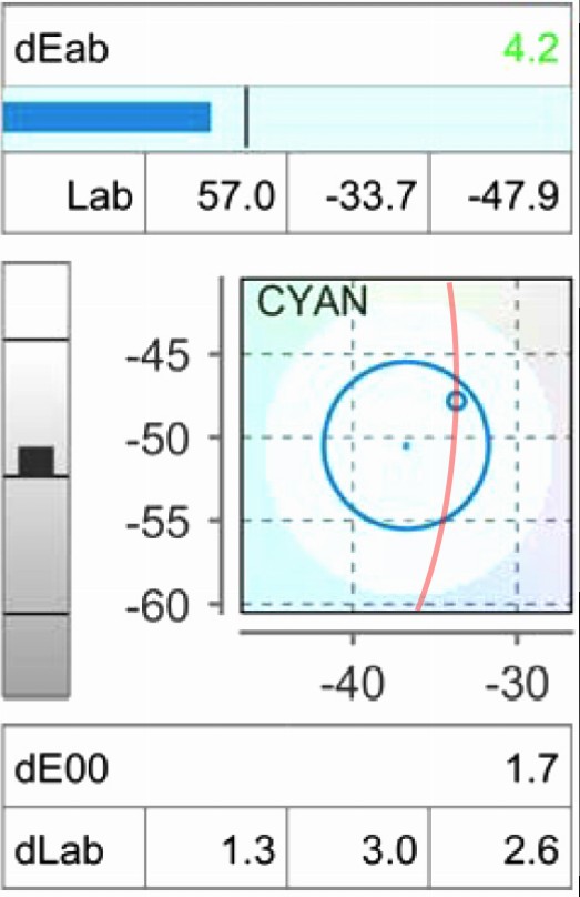

We just bought a new Techkon Specto Dens, and I've been learning how the GrayGuide works on it. It defaulted to ∆E2000 for primaries, but if you measure an R,G, or B patch it will display ∆Eab. I was trying to understand why.

Not if the B* and L* moves but just B*. Say if the B* goes from -50 to -45.

I told you wrong earlier on the cyan move. I was responding during intermission at a hockey game, so that's my excuse.:D Here is a document that helped me see how LAB moves. It was provided to move from Heidelberg as a scan a long time ago, but I have cleaned it up, so it may help someone else. I have verified this to be correct. I scan P2P targets weekly. If you were to track it in an a*b* view, you could draw out a path. Maybe look something like this.
Not sure exactly how much a* moves, but not much. Mostly cyan moves up and down in L* and b*, like the document says.
