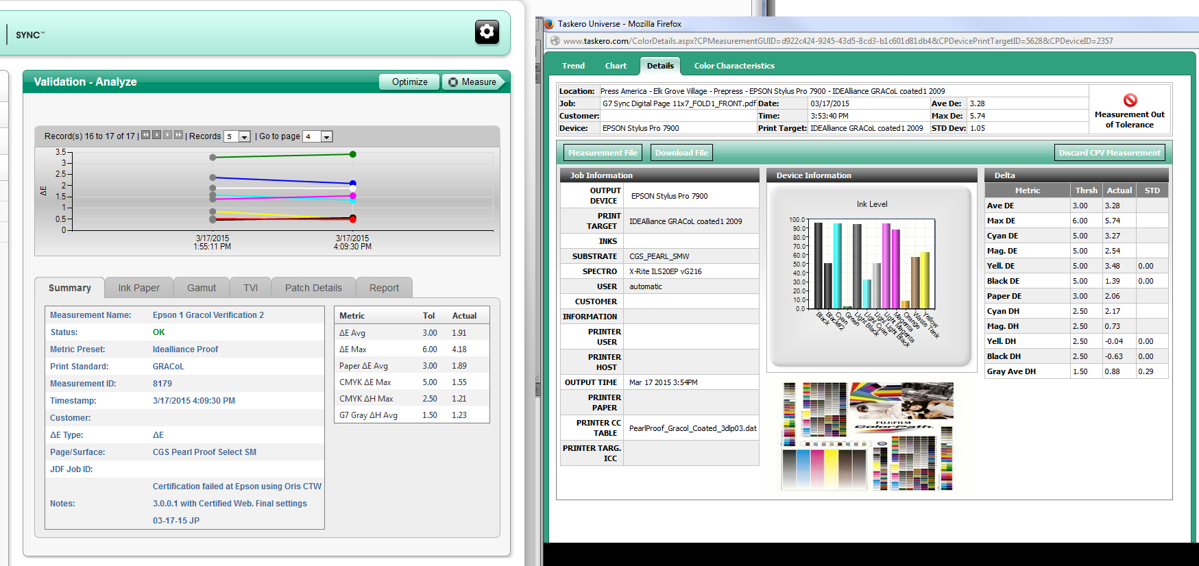

Good Morning, We are a general commercial printer using 2 Epson 7900s with xRite inline spectros for proof certification using Certified Web. We are using Screen Trueflow Pre4m to send pdf files to Oris CTW 3.0.0.1 for proofing at our 7900's . We recently upgraded from CTW 2.5.1 to 3.0.0.1. We worked out all the upgrade bugs and everything was working well until last Thursday when suddenly all our proofs from one proofer started failing. We have manually validated them using Fuji Color Path Sync and the proofs are well with in spec. We have double checked all our settings. We contacted Epson and they had us swap specto units. The proof still failed verification and passed manual validation. They really did not have much input beyond swapping units. They would like use to replace the spectro unit. I am not sure the spectro unit is failing. We have done several spretro alignments and restarted the proofer. Does anyone have any insight about Epson inline spectros or possibly something with Oris CTW that may be causing our problem ? Any input or suggestion would be appreciated. - Jeff

Please see the screen capture - The left side is validation via Color Path Sync and the right side is the spectral data from the inline spectro

Can you generate the full report for both? What you've shown me isn't really easily broken down. If not can you give me the measurement data text files themselves? I can throw them into Certified Web and see if I can point anything out. I'm curious what patches are throwing it off so bad as the primaries look reasonably good.
Observations that I can make:
It looks like your on the edge of dE max for both readings. Your manual measurement is using dE "classic". Is your inline measurement configured to use dE "classic" as well? It's best to use dE2000. I'm pretty sure Fujifilm should have you setup for dE2000 to begin with.
The paper that you are using isn't OBA free. Is there a chance your manual device is configured in M1 while the onboard is M0 and this is causing the mismatch? More info on M0, M1, etc. from Techkon and X-rite
Looks like there was an update to certified web on Thursday the 12th, the same day you ran into issues. Did you update the software on Thursday? Could the issues be with the update?

If you can provide the same data for the manual measurement I could do a comparison. It'd be better if you could give me the reading file itself instead of the results computed by Taskero. Regardless, your i1(model?) scan shows your Cyan as 1.36dE while your inline shows 4.92dE. This leads me to the measurement devices and measurement modes being utilized. Do you have a third device that you can use as a reference?

CTW is reporting the embedded device is using M1 and I believe our i1 is also, will double check these also. And thank for M1 and M0 info.
I thought that all spectroproofers were M0 but it turns out I was uninformed. There are newer models since October 2014 that are M1/M2 compliant. However, your device identifies itself as "X-Rite ILS20EP vG216" which is referred to in the 2012 manual documents. Unless Epson and X-rite did not change the model numbers your device is reading M0. See link for more info: Epson Announces New SpectroProofer In-Line Spectrophotometer | Epson US Newsroom UPDATED INFO ABOUT THIS IN SUBSEQUENT POST REPLY
Also your i1 if it is not an i1pro2 is also reading M0. An i1Pro2 can be configured to run in various M modes. If you are working with OBA papers (which you are) it is important that all of your measurement devices be in the same configuration.
I thought that all spectroproofers were M0 but it turns out I was uninformed. There are newer models since 2014 that are M1/M2 compliant. However, your device identifies itself as "X-Rite ILS20EP vG216" which is referred to in the 2012 manual documents. Unless Epson and X-rite did not change the model numbers your device is reading M0. See link for more info: Epson Announces New SpectroProofer In-Line Spectrophotometer | Epson US Newsroom.
Our i1Pro2 does read cyan with a 1.36dE. However patch A2 (100c) reads 3.27dE with our inline. I think the 4.92dE is from patch A1 (100c 60k). I saw the sample PDFs you posted, I can give you the text files but do not have a PDF printer setup on the machine that runs Certified Web so I do think I generate the PDF report.

You need to use the dE formula required by the specification being proofed. For example, with Fogra39 / ISO Coated v2 – one has to use dE 76 / dE ab. This should not be an arbitrary choice or based on whether a machine is inkjet or toner based. Calibration is different, however we are not discussing calibration here but certification to a specification.
It looks like something is wrong with your inline spectro. I would first totally, completely, absolutely verify that all of the software is configured properly. After that is exhausted I'd talk to Epson about upgrading to the ILS30EP or replacing the exact same ILS20EP unit.
