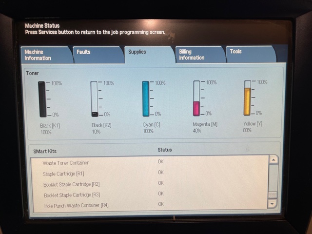

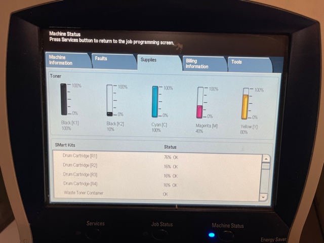

Attached is the screenshot of the toner levels

I am also realizing that it is hot and humid here. Any idea on how to get the humidity lower on paper supplies so I can experiment if that is the issue here?
If you have high humidity, you will absolutely get faded prints. I had this exact same issue with a toner-based office copier in my department. The humidity was well over 70% and the culprit was something with the roof AC unit for my department. If you can put in a dehumidifier, that is your best (and likely cheapest) way to help dry out the room.
