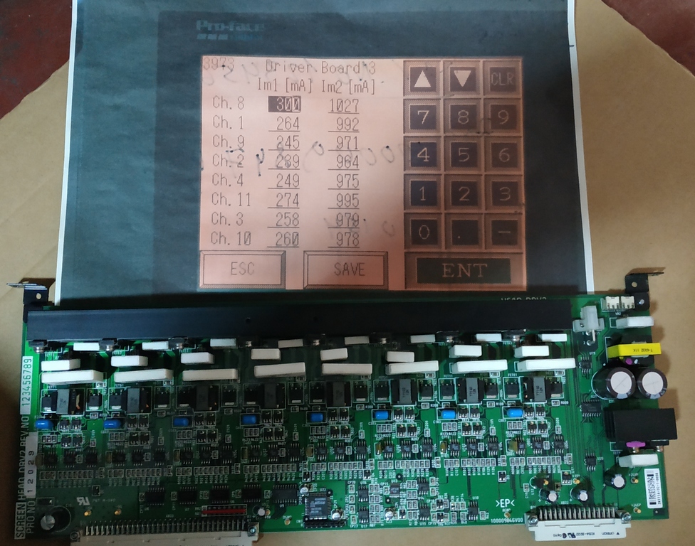

Laser drive board #1, most likely faulty. To complete the diagnosis, you can swap boards (for example, #1 and #3 boards, AND ITS CURRENTS, please see att. photo). If after such swap, the CTP starts to show an error E4e03: Excessive current in the LD drive (driver 3 board). - then it's definitely a faulty board.
Hope this helps you diagnose!
Good luck!
