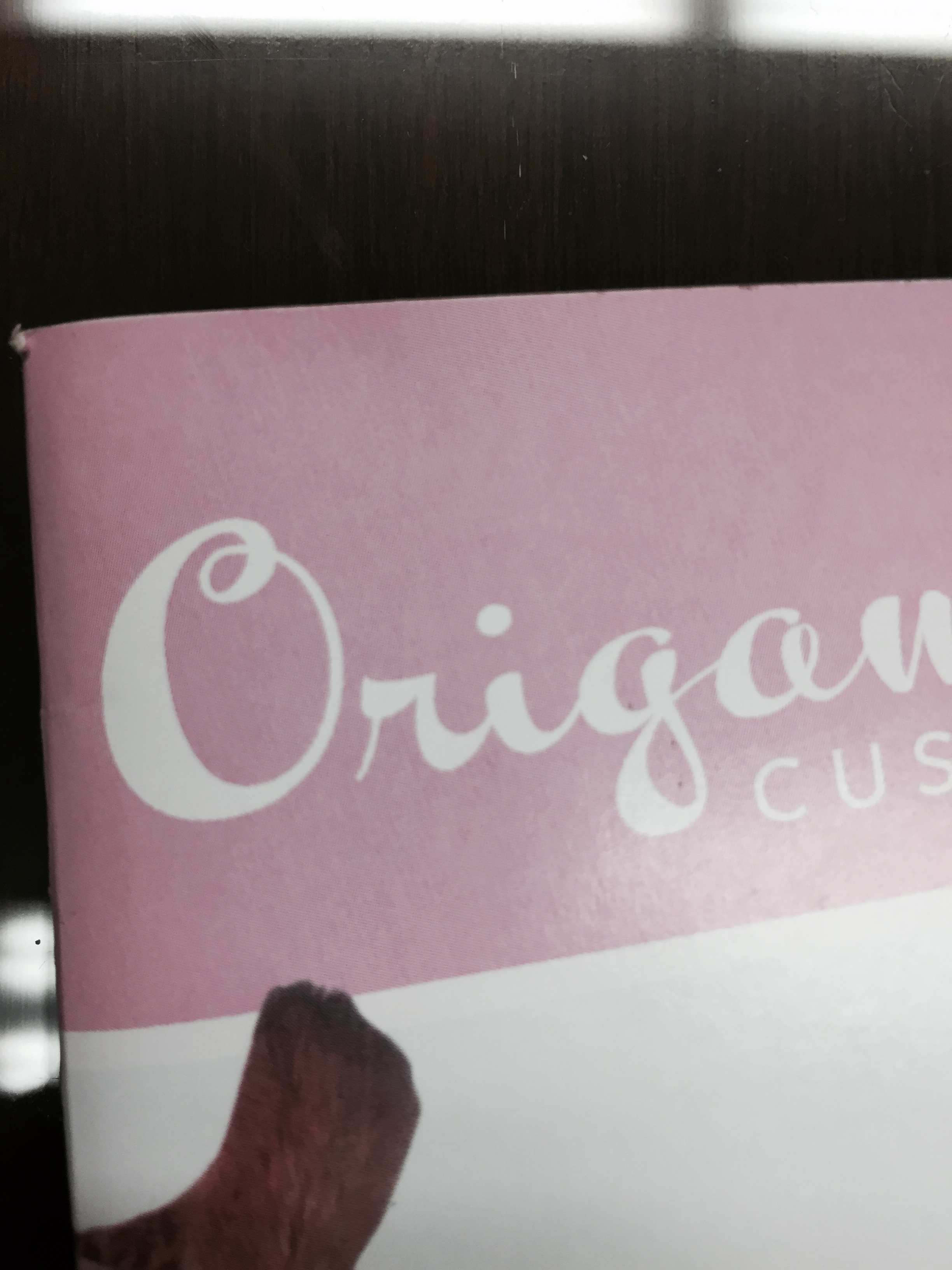

Can anyone tell me why I might be seeing lines across a sheet, in magenta, round dot that is printed 175. Ultimately the lines run at the same angle as the dots (15 or 75), but the dots are round, so why would I see a line?
Sorry if this is way off because I cannot see much in your photo but this might help you
http://www.tappi.org/content/events/09papercon/papers/Antilla.pdf
My opinion of this problem is that you are seeing - Secondary Scumming.
