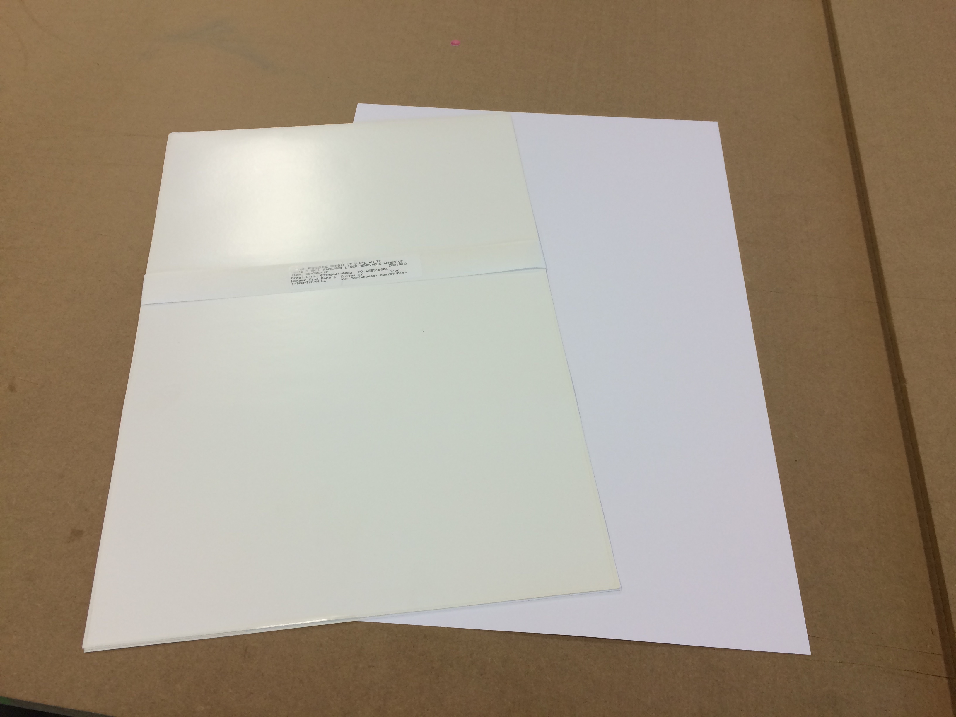

This is the picture of one of the brands mentioned above compared to a stock 12pt Carolina cover. I don't want to bash any brand just looking for something brighter and does not look "aged and yellowish" like this.

sorry for being defensive Keith, not my intent. Please see a picture I posted above. This is one of the brands you mentioned compared to 12pt Carolina paper before it even enters to print. Thanks. I appreciate your help and comments.
Ha! Ha! That's Mohawk brand! I just got some ultra removable adhesive vinyl in today for a job! Now I know why the model and settings of your Xerox doesn't matter... because your talking about the shade of white BEFORE it even goes through your machine! Ha! Ha! What does matter in this case is the brand of paper and the specific line of paper in that brand.
I just took my swatch book of Carolina Cover (I no longer stock it because I hate that blue-white shade) and campared it to the two kinds of Mohawk adhesive vinyl that I have here- Mohawk Pressure Sensitive Removable Adhesive Vinyl, 3.5mil white 12 x 18. I also have a little bit in the Ultra Removable Adhesive and neither one looks yellow compared the Carolina Cover. Call Mohawk. They stand by their product and have been extremely kind and helpful whenever I've had a problem. It looks like you got a sample pack and it looks like it may have been sitting on the shelf forever! I imagine they would gladly send you new samples.
