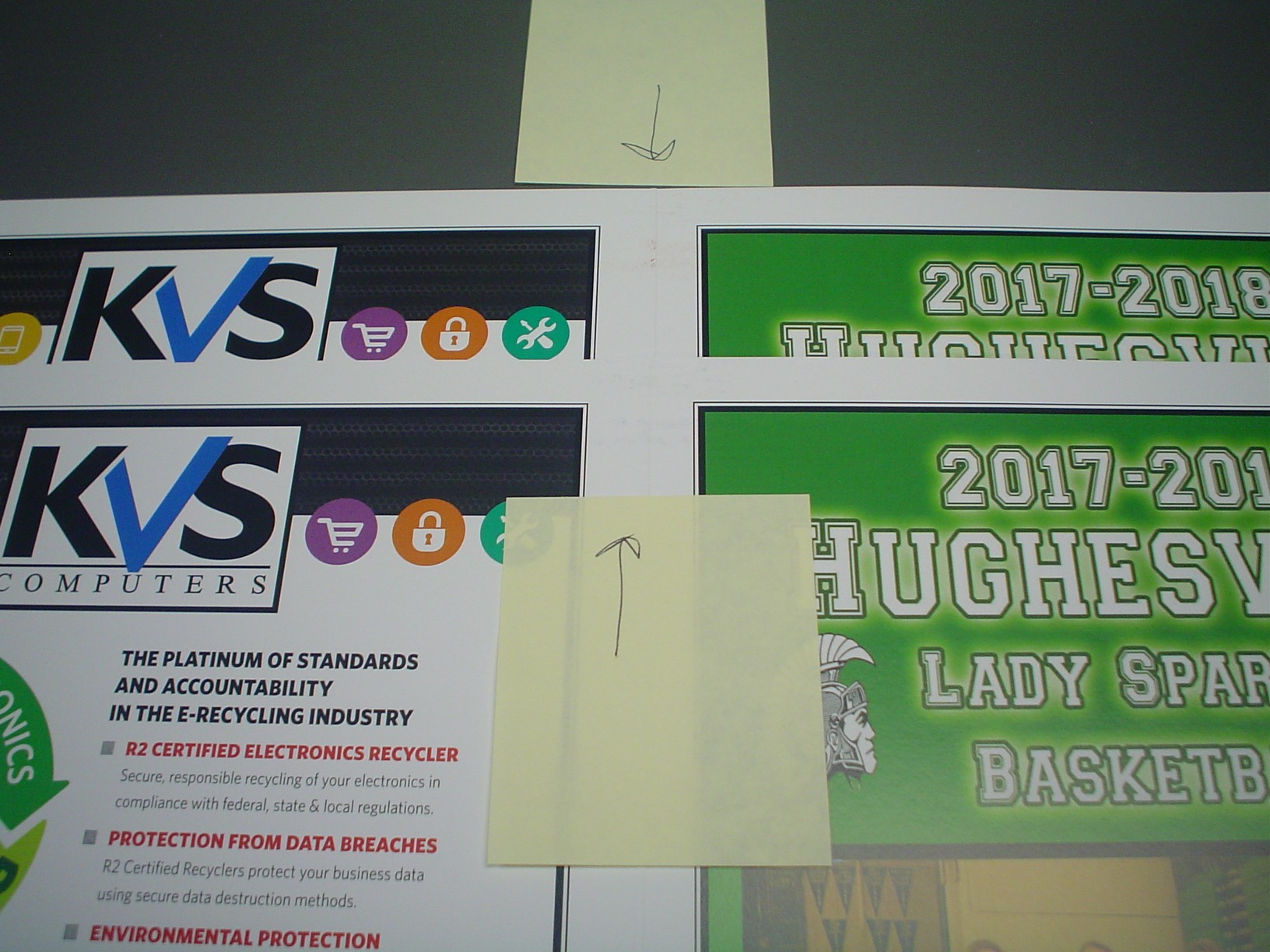

I kind of hi-jacked Manafaith's post about Ghosting problems on his 9100 asking about a print problem I was having with mine. Finally got to the bottom of it. My tech replaced the "Potential Sensor" in the magenta and I haven't seen this issue since. This is located just above the center of the drum. It seemed pretty easy to replace, remove 2 screws and the bracket that holds it comes right out, swap in the new sensor and put it back in. That much I could do, but then he had to do what looked like a lot of pretty complex stuff to calibrate it. Just glad it's fixed!
