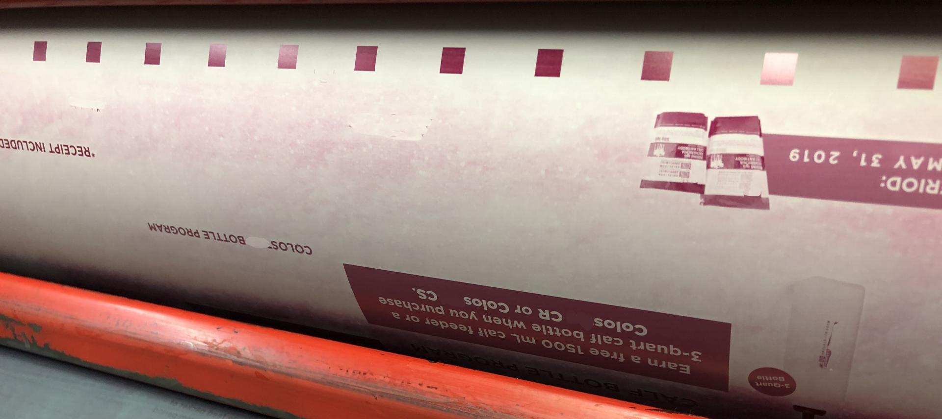

This is an example. We took this plate and cleaned the background before mounting it. I would suspect the unit, but this seems like an odd pattern. I have checked all rollers and while they are swollen at the ends, we have been running up to this point without anything like this. Any thoughts?

The Photo you posted shows......... Residual Plate Coating, so what procedure DID you use to process this DoP plate - Hand or on Press?
Next time you have this Plate Problem do the following 1) Using a Plate Deletion Pen, delete a small area of "Scum" next Gum -up this area and buff the Gum Dry with a lint free cloth,
this Area should print clean.
Regards, Alois

Most were put directly on to the press for cleanup. On the last couple we tried some alternative methods before haning on the press. We first tired wiping down with fountain solution several times until the towel looked clean, but the plate still had a purple tint to it. Then we wiped one down with a plate cleaner and preserver called hydroimage and another with Plate Savur. Both of these caused the background to look very clean like they should, but when mounted, still had the background pattern.
The one off the bottom that worked perfectly, we just hung on the press and dropped the water. It cleaned up in a few revolutions and ran perfectly.
Check interleaf paper sheets for wrinkles, slightest creasing indicates humidity in storage. Were the plate boxes allowed to acclimatize properly in ctp room. Do you control humidity in ctp area. Test clean a plate by hand again dropping a small amount of fountain solution allow to soak for 10-15 seconds then wipe in one pass with a clean white cotton towel, it must remove the entire coating in that small area. Rubbing repeatedly in one spot may in fact redeposit the pigment hence the toning.
