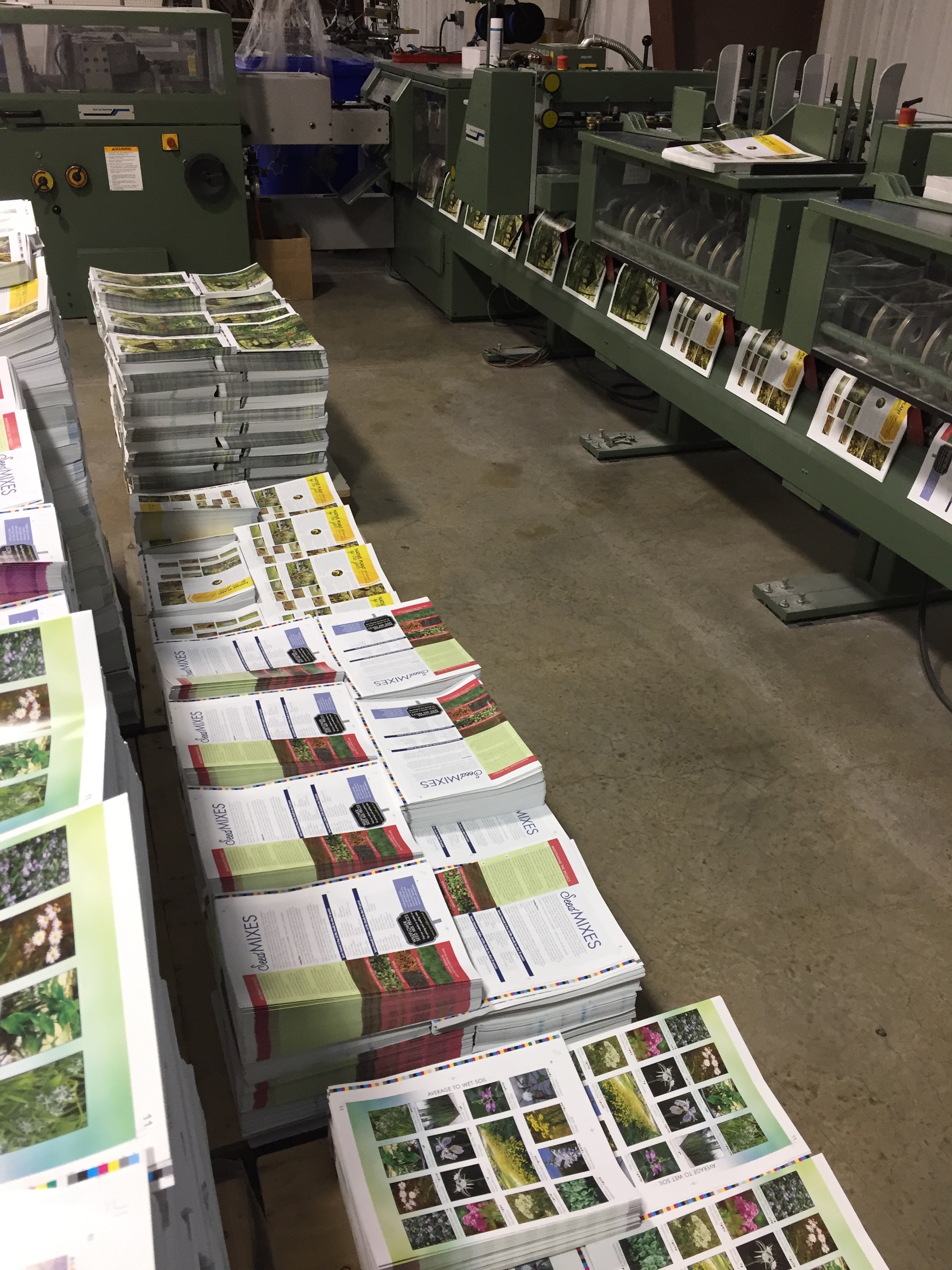

We run them on our Minuteman saddle binder from time to time. We either collate the book and leave the face trim alone to do a second pass and stitch in the envelope, or you can trim the press sheets to finish size head to foot prior to folding and do it in one pass, but I don't think the final product looks as good as the two-pass method. Most of the time we use #9 remittance envelopes.
