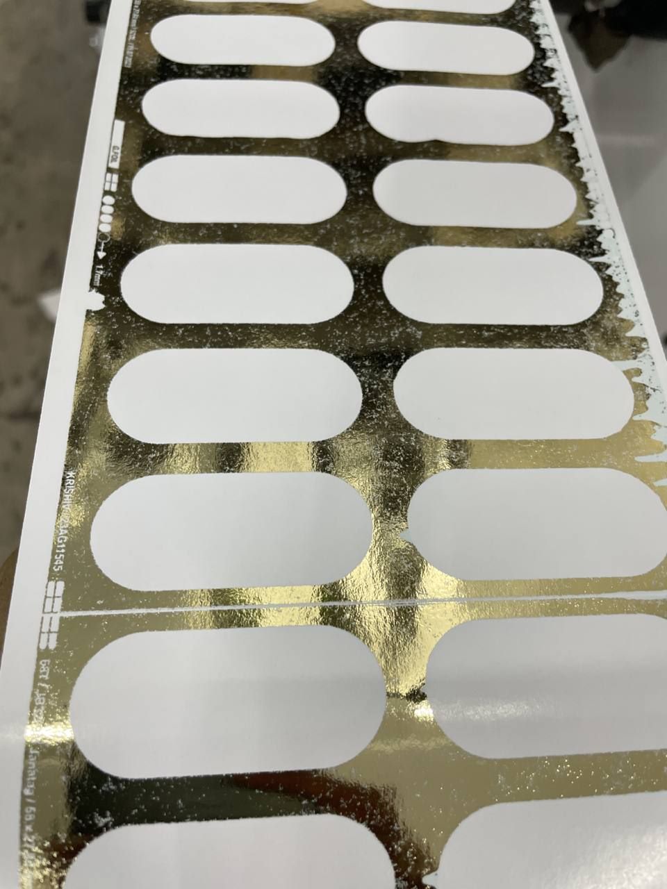

1st Job
Material : Chromo
Anilox : 300 ( Metal Anilox , not ceramic )
Foil : Gold from ITW
Problem : Transfer almost fine but font and design edges not sharp , looking crooked and unfinished.

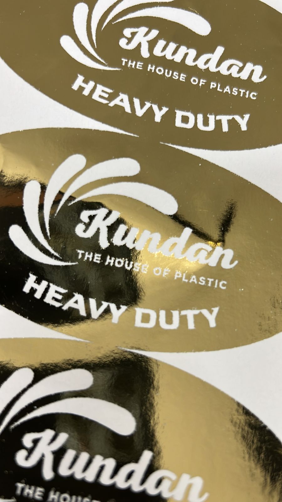

1st Job
Material : Chromo
Problem : Transfer not happening properly , uneven and incomplete transfer
