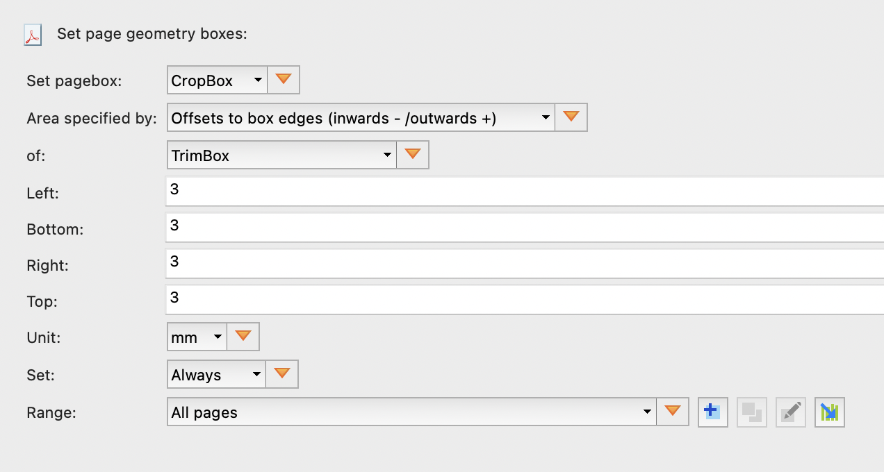

Hi @nikleon71 ,
With a callas pdfToolbox Fixup, you can crop a PDF based on any reference, for example a Page Box, or a coordinates based on page origin.
In your case, you can use the Trimbox center as a reference, and add 3mm to all sides.
The Fixup you're looking for is "Set page geometry boxes".
In pdfToolbox 15 the settings could look like this:

Hi @nikleon71 ,

Thank you, unlikely we have Pdftoolbox 13 and that option is not included
