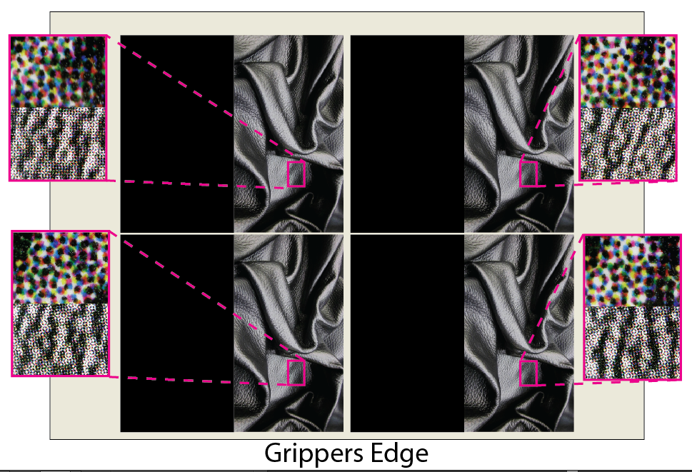

I have an issue with a job (please check the attached picture for more detail)
- sheet size 750 x 540 mm, 157 gsm, coated paper.
- CMYK job with color sequence KCMY
- We print on a sheeted offset machine, just installed 4 months ago.
- I let machine run stable and take a sample sheet.
- On the picture you will see 50x zoom and 500x zoom by a digital microscope in ONE SHEET.
- We all find the different rosette of dots in the left-upward compared to the other position.
- Then I got a different grey shade in the left-upward position, it looks a little bit more yellowish than other.
I had remounted the plate in yellow unit, and tried to make diagonal value in print console nearly zero. But the rosette of dots is still the same.
I understand that if I can make the same rosette of dots in all 4 position, I will have same grey shade, am I right?
Anyone with experience in offset sheet machine please tell me how to get same rosette in all area of printed sheet.

DeltaE

Your advice: imaging all four color in one plate show me something interesting. I found that the rosette in one plate in not the same in whole plate. Somewhere I can see clearly white in center and a very shape white circle, but there is some area not like that. So I think even the sheetfed machine has very good registration and very stable paper transfer system, I still can not get the same rosette in all area because it is different when combined CMYK in plate side.

We both know that middle area of sheet is stable area than on the side. But we can see the rosette of right side same as the lower-left position. And I also request printer to fine adjust registration four corners and of course mount plate then the diagonal value on press console is nearly zero. Then I can confirm that we have good registration when I check the registration marks visually by microscope.

Yes, of course we use some color strip. In the picture, it is not the printed sheet, it is only a artwork to help me showing my issue more clearly.

Clarification: This 4 Colour Halftone Image, are you printing the same image 4 - UP on the Sheet ?
1) The L/H leave edge image is the problem ??
DeltaE,
My problem is the grey of picture in lower left, lower right and upper right are same, but the grey in upper left is more yellowish than others.

OK...... I'll start again, THE same image is printed down onto the Plate --- 4 times YES /NO
On a printed sheet 3 of 4 the images are printed correct - YES/NO
The 2 images at the GRIP EDGE of the sheet are OK YES?NO
The 2 images at the leave edge ... I (one) is OK and 1(one) not YES?NO

Gentlemen and fellow Lithographers,
Before we ramble of into the realms of Screen Rulings and Rosette Patterns, we have a problem to resolve.
Salient Points:
A print run of 4 > up x 4colour identical images printed KCMY, of these 3 were printed OK and 1 with tonal colour variations.
What are the ODDS of CtP imaging to reproduce 1 image out of 4 - incorrect >KCMY printer separations images ???
Next, we need to compare the suspect image on the plate, then on a printed sheet of each
single colour KCMY .
DeltaE, if these steps have been done- what are the conclusions ??
