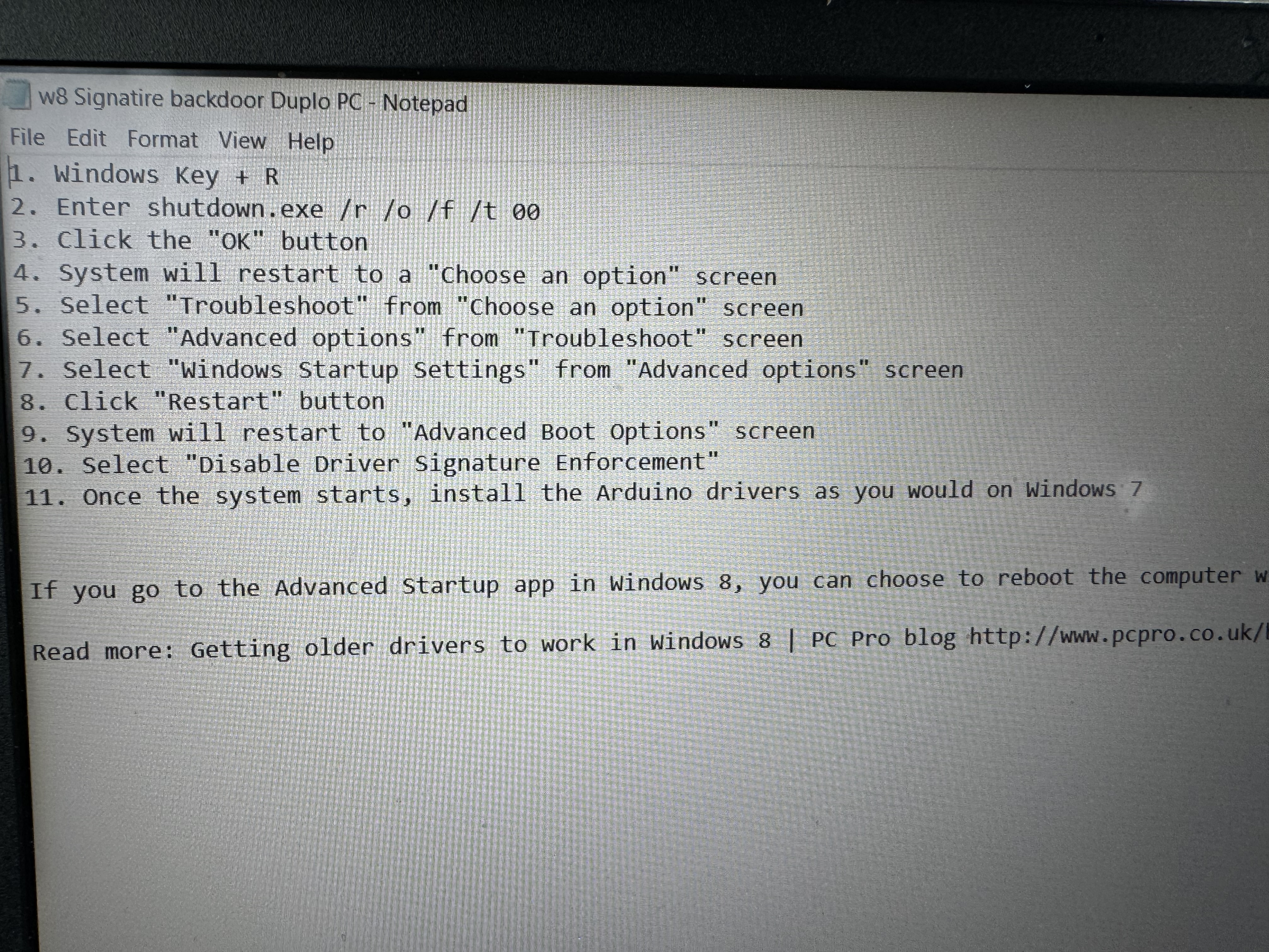

We have a Duplo system 3500 (feeder, stitch, trim square) and it has a PC (all in one) Hardrive failed. Have replaced with Win 10 - Has anyone encounter this yet? Seemed to install Ok however opens with Communication error and all is set as previously so maybe mapped wrong drivers or maybe Wind 10 no good for this software, any input appreciated.
On Duplo units there is firmware inside the Duplo machine and software on the PC. Both have to be compatible versions. Your PC software probably needs an upgrade and then you will have to upgrade the firmware on the individual units. You might want to check with your local dealer for support.
