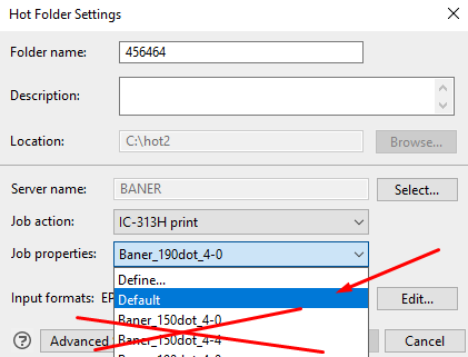

hello everyone.
I have encountered this problem: when processing any file, fiery server services are restarted.
this situation on two servers.
hot folders and FeiryHF located on the computer with the fiery server, permissions to write files are available, all attributes are removed from the folders.
used different presets in the settings, including default - the result is always the same
used different paths - the result is the same
video
if anyone has encountered this problem, please help

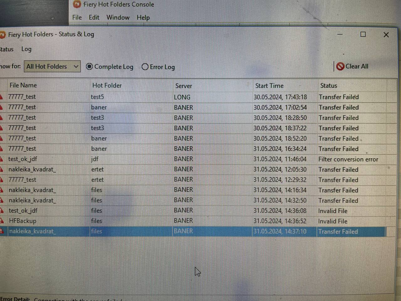

The logs say file transfer error
