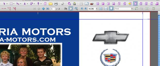

This is how I do it. The icon is show page boxes works fine for me.
-Dan
