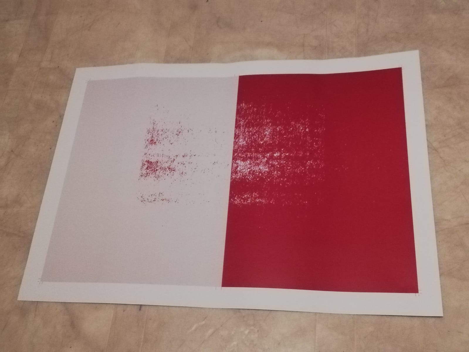

See photo, I printed recently with the Heavy fuser again on not special paper, namely 250 grams Gloss Coated from Xerox (stock noted on Recommended Media List). It's interesting that the non-fusing part stops at a certain point.
I think there is too much toner on paper. If the layer of toner, on the paper, is thick this is exactly what will happen.
When the paper passes through the fuser unit, the toner melts and gets into the fibers of the paper.
If there is too much toner, it can no longer get into the paper and sticks to fuser belt/roller.
I also tried converting the files to print to have less toner with Belgian VIGC profiles, without succes.
On the Xerox Colour C60 I think it's possible to lower down the density on the machine itself in Engineer mode, but not sure if that would be a good idea.

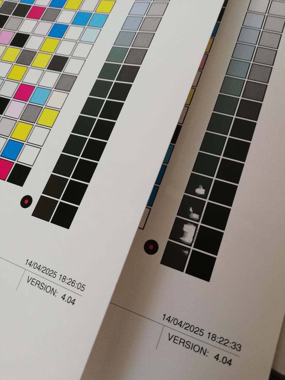

Here I show two calibration sheets on the same paper (Xerox SuperGloss Cast-Coated paper 250 grams), on the left side I used the Standard fuser with brandnew sleeve, on the right side I used the Heavy fuser bought from a German Xerox partner with enough pressure to fuse I would say, but that Heavy fuser is failing. On both calibration sheets I off course used the same toner.
