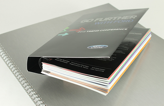

Something like this may be better suited.
Exposed-screw-post-screw-removal-H_Co-1023px_483e1756-d1e4-49f2-b9dd-415c6ad1a6c7_1200x.jpg

This is exactly what I was thinking about as an alternative. If the text pages are torn, frayed or out of date at least they can be replaced with spares.

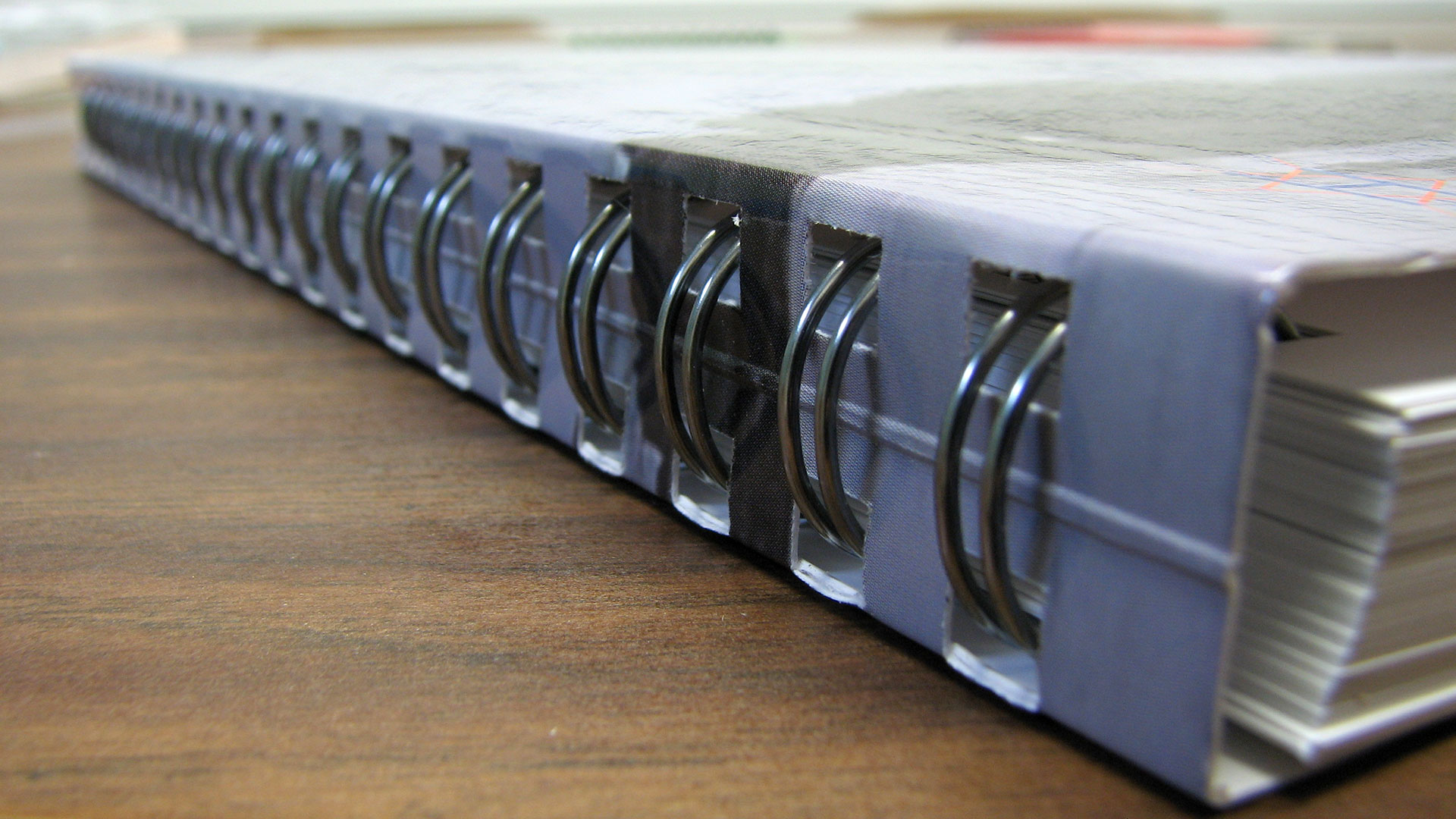

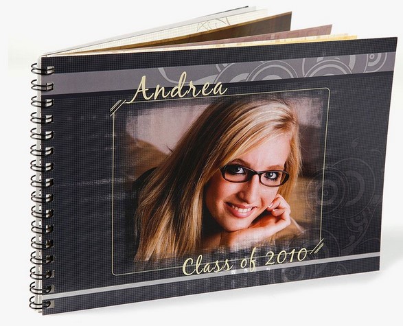

Another vote for Wire-O binding (AKA: Twin-loop binding). They are as easy to assemble as coil or comb bound, but look nicer. You can even conceal or semi-conceal the wire-o as shown below. If you really want it to last a long time, print on synthetic media. Our digital presses really like the Synaps XM by Nekossa.
View attachment 293087View attachment 293088View attachment 293089
It showed this to my customer but unfortunately they don't like Wire-O-binding. They said "it looks like a document" !!!!!!

Binding methods often present a compromise between aesthetics and functionality.
For a document or report intended to be read at a desk or table, wire binding presents nicer, particularly because the open spread sits even either side of the mechanism. However after it has been folded back on itself a few times, the back cover can become detached - particularly where the finishing is nicely round, per the Wire-O nomenclature, as opposed to the Squashed-D variation.

Back to the OP's dilemma, for a coffee table book at a hotel, @pippip 's screw post suggestion wins hands down IMHO
