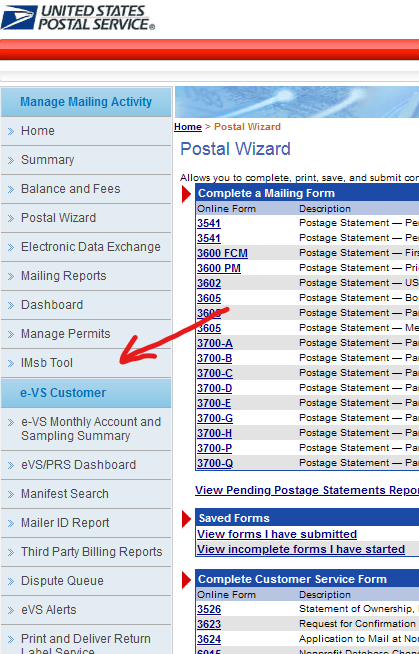

If your mailings are small and you want to use IMB you may want to check out the IMsb Intelligent Mail small business tool, it's free to use on USPS site for smaller mailings.
The tool is available when you're logged into the Customer Gateway
I highly recommend this process.
It's a little rough around the edges but once you get it figured out it's an amazing little tool.
You are allowed to process lists of up to 50,000 recipients. You can process first class or marketing mail class using letter, card, or parcel. There used to be an annual limit of 250,000 pieces per year, but that limitation has been removed. You DO need to have a permit though.
You select which kind of mailing you want to do, upload your list, and it will help you process by adding +4 and IMB info, as well as allowing you to remove duplicates or undeliverable addresses. You can then have it spit out labels you can print and attach to mailpieces, or a list you can use to mail merge before printing. It then gives you some paperwork you can just bring to the BMEU and they scan it for acceptance.
I was hunting for a solution too, but once I got used to the iMSB tool, we have no need to pay for one since USPS seems to allow us to do it for free.

The IMsb Tool is not designed for use by Mail Service Providers who preparemail on behalf of others. Other options to take advantage of Full-Service and Intelligent Mailbarcode benefits are to contact a Software Vendor or Mail Service Provider (MSP).
Oh man I'm glad I'm an inplant so I'm not in violation, but dang I had no idea. I figured small print shops were the "small businesses" they meant.
