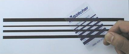

I really appriciate your opinion, but to clarify: why measure all rollers. Let's say one 700 Roland with 4 form rollers on every of 8 decks (that's most interesting rollers). Assume that all 4 rollers wore out at same time. So we need to document 1 roller per deck with 3 measurements. That would be 24 measurements. All other rollers would be set up with good-old ink stripe method according to stripe that we have on first roller.
Another thing in my mind – it's documented and measured data to explain to the tops necessity to buy new rollers.
