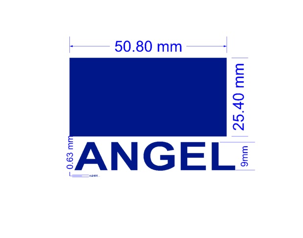

just would like some inputs : printing heavy colored band together with small logos and some micotext, will it help if i rip it at 175lpi and not with 150lpi? or any suggestion to blend heavy colored band with small pts text (japanese and chinese characters)

Are the logos and text reversed out of the coloured band, or are they separate elements?
just one plate sir. very similar to this attachment. the characters in the bottom
Screen ruling won't make any difference, as far as I can see there are no screened elements. A competent printer should be able to print this with no problems without you needing to do anything special.
