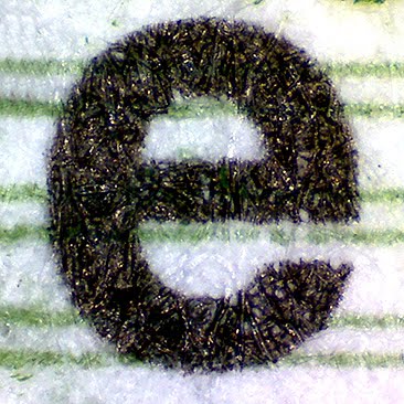

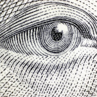

Engraving
Engraving is typically used for currency/bank note printing, stamps, and sometimes very exclusive stationary. Type is very crisp and sharp. The process is capable of extremely fine detail and as a result is used to print security microtype. Halftones are usually created with line effects rather than a conventional halftone screen. Softly passing one's fingers over the printed work will reveal a tangible texture due to the raised ink.

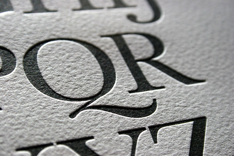

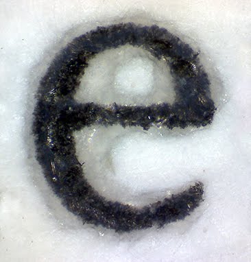

Thermography
Thermography is commonly used on wedding invitations, letterheads, business cards, and greetings cards as an attractive alternative to the more expensive engraving process. Type has a raised surface texture similar to engraving however, with thermography type appears to be printed under a transparent coating. The low resolution of this process makes it unsuitable for quality halftone screening.

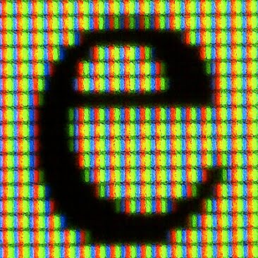

LCD display (print to screen - just for fun)
The letter "e" as displayed black against a white background on my laptop's display. Since the LCD display produces no light of its own, it requires a cold cathode fluorescent lamp situated behind the LCD panel. Electronically-modulated pixels filled with liquid crystals are arrayed in front of the light source to produce images in color. Passing the backlight through the red, green, and blue liquid crystals recreates the backlight white, while blocking the backlight creates black. Anti-aliasing of the letter helps to smooth the shape of the letter form and compensates for the relatively low resolution of the screen itself. Note that the pixels forming the image are not square but rectangles.
